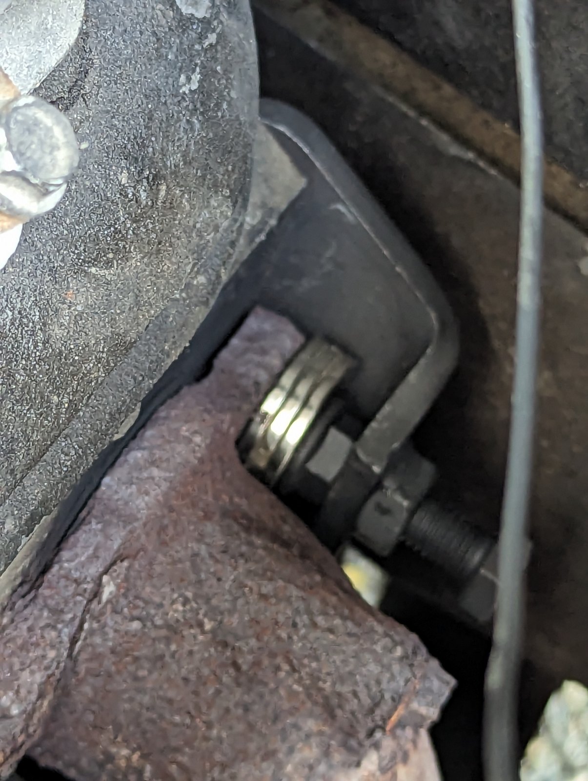

I went from the top, but used magnets to hold the plate clamp in place.
And coned the first but of the bolt to guide it in...
It still took much longer than I thought it should... But thought I would share what worked for me.

I couldnt' get the ground-strap bolt off the back of the block where the top bolt of the clamp attaches. There's a heatshield between the firewall and the block that eats up some space.

Were you able to remove those? And how did you go about it? Wheel well?
Take the shield off and then wouldn’t you be able to get in there with a ratchet? Or maybe you could with wrench. They tend to be flatter than ratchets.

No, I should have specified that I'm dead in the water on this one. I initially tried every combo of ratchet and/or wrench, but no luck. I don't even know how to get that heat-shield off. It might be much easier on a 2WD vehicle, but I wouldn't know.
I even bought a set of flex-head wrenches, but even that didn't give enough leverage. So... now I'm just pretending that the leak coming from that one exhaust port is in time with my music.

put the flex side on the bolt, put something thru the open end against something and pry it for leverage. I do remember that bolt being crazy tight, like I thought I was going to break my wrench on it haha.
