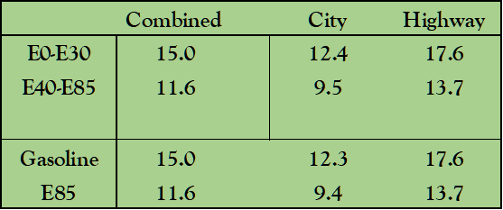

fueleconomy.gov's opinion:
fueleconomy.gov said:
E85 (Flex Fuel)
E85 contains 51% to 83% ethanol, depending on geography and season.
Summer blends tend to have more ethanol, while winter blends have less.4
MPG.
Due to ethanol's lower energy content, FFVs operating on E85 get roughly 15% to 27% fewer miles per gallon than when operating on regular gasoline,
depending on the ethanol content. Regular gasoline typically contains about 10% ethanol.5
If E85 costs at least 15% less than gasoline in your area (where is that?),
you're likely getting good bang for your buck.
