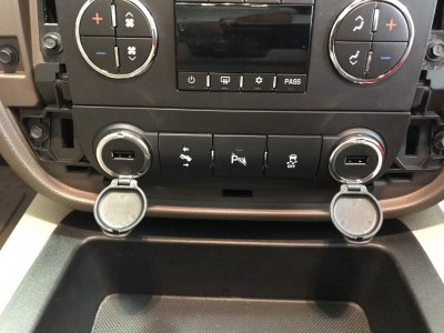

Has anyone installed dual OEM USB connectors in the dash? I’m having a problem finding a mini USB splitter to connect both to the factory radio(2012 Yukon w/nav). I can find micro USB splitters all day.

Yea’, I may have to go the China route. I was just trying to keep from waiting over a month on it.

you could also check cable matters & mono price they both sell all kinds of adapters

Check Newegg.com for what you're looking for. If they don't have it, it doesn't exist.
I put those in soon after buying our truck and removed them for more powerful flush mount ones with 2 2.5A ports in each.

Did you have problems with them charging or playing music?

Not at all for charging, my truck is older and did not have ability to play music through them, that was added in 2010. When we're all in the truck, there's just too much junk to keep charged up! So the dual adapters that charge at 2.4A and 2.5A for both ports in the adapter works better for us. Bought a cell phone holder that fits in the cupholder that has cigar lighter sockets and USB ports too and it plugs into one of the truck's cigar lighters now on the dash. Plus I have a dash cam that is not permanently wired either.

I don't think the radio can support more than one device at a time since that's all it was designed to handle. Plus, the stock radio doesn't put out much amperage to charge even one device while that device is being used. I was using my phone to navigate and play music on the way home when we bought my wife's Yukon and the battery was still dying. The newer trucks basically have USB hubs in the receptacles but they are designed to handle multiple devices and also have a separate 12v input to provide enough power to charge more than one device at a time.

When you had the oem usbs, what did you use to connect them to the radio?
