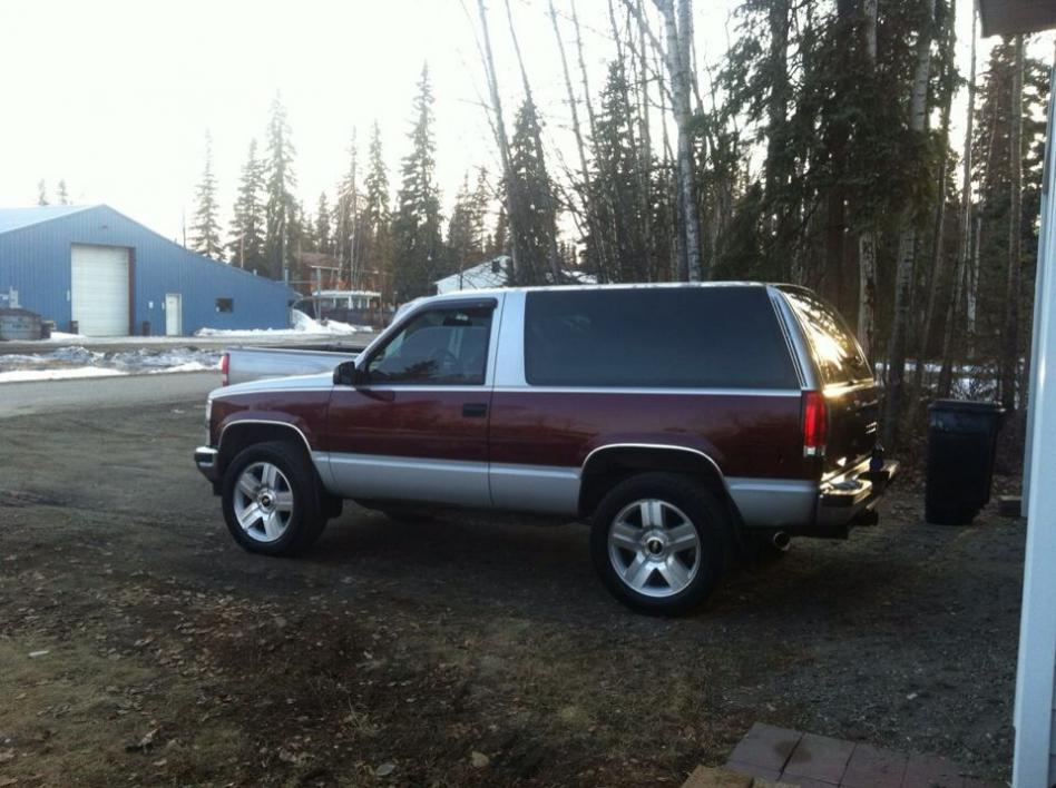

Ive been researching for my buddy to lower his 93 k1500 blazer and i cant seem to find drop spindles for it only thing i can come up with is torsion keys is that the only way of dropping the front end looking around and couldnt find anything on it. of course no thread is good with out pics so the pic attached is the said blazer needing lowered.

well i was reading you can get 4" out of the front with keys and 5-6" in the rear before you got to notch the frame in the rear figured a 2-4 or 3-5 just to get rid some of that hideous fender gap and yet keep a decent ride.

try uncranking the front keys and see what it gives for drop. Then an axle flip for the rear. Not sure what that will give you but 3-4" sounds right.
