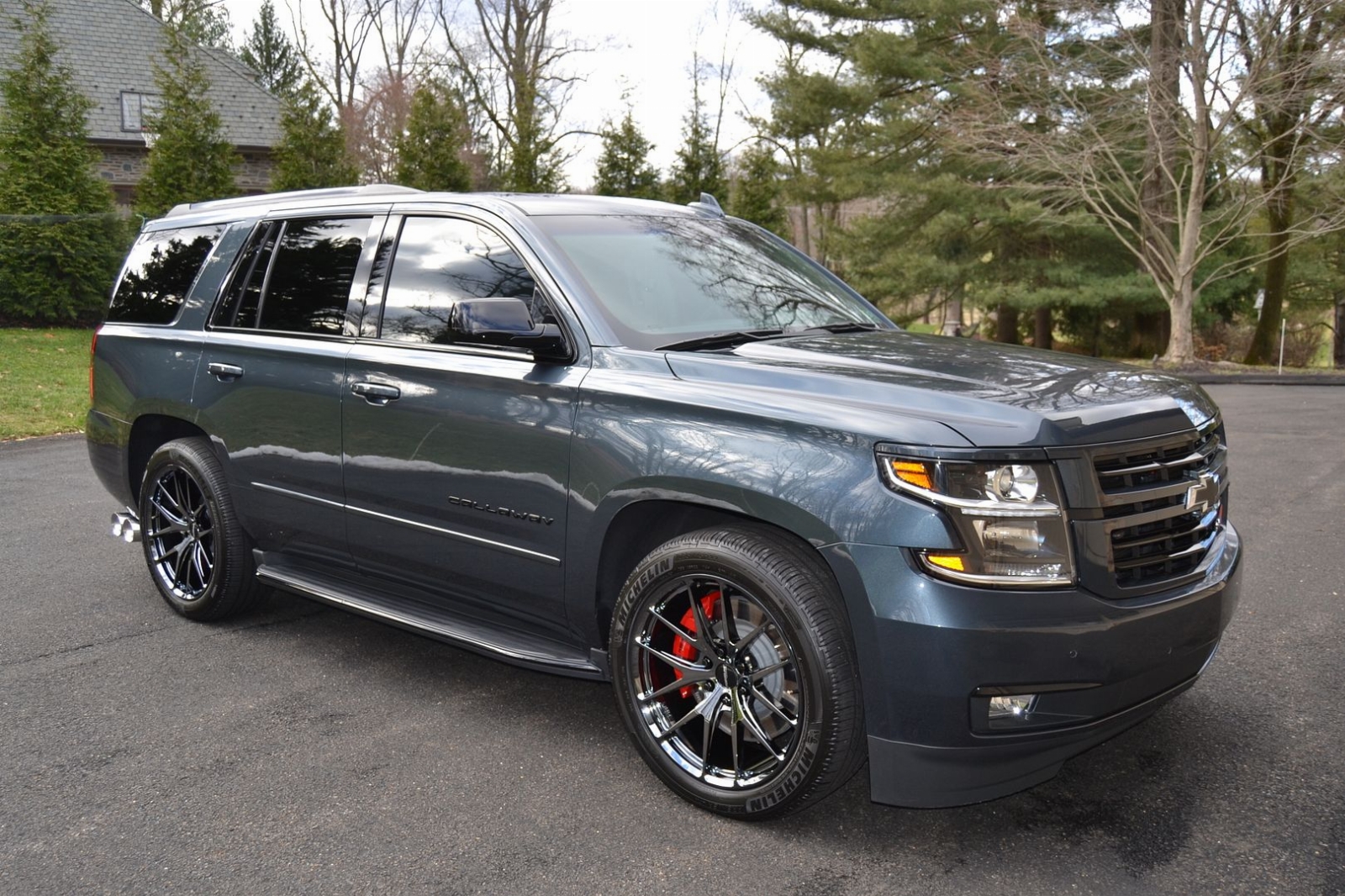

I tow a 26 ft enclosed snowmobile trailer in the winter in deep snow, and yes it plows snow with the front end, but never gets stuck, I have had chains on all 4 wheels several times, gives the supercharger a good workout
NIevo
May 15, 2009
110
65
Lewiston, ID
Man, I really like those wheels! What are they and what size?
Also, is that an RST or did you replace with RST pieces for the chrome delete?
