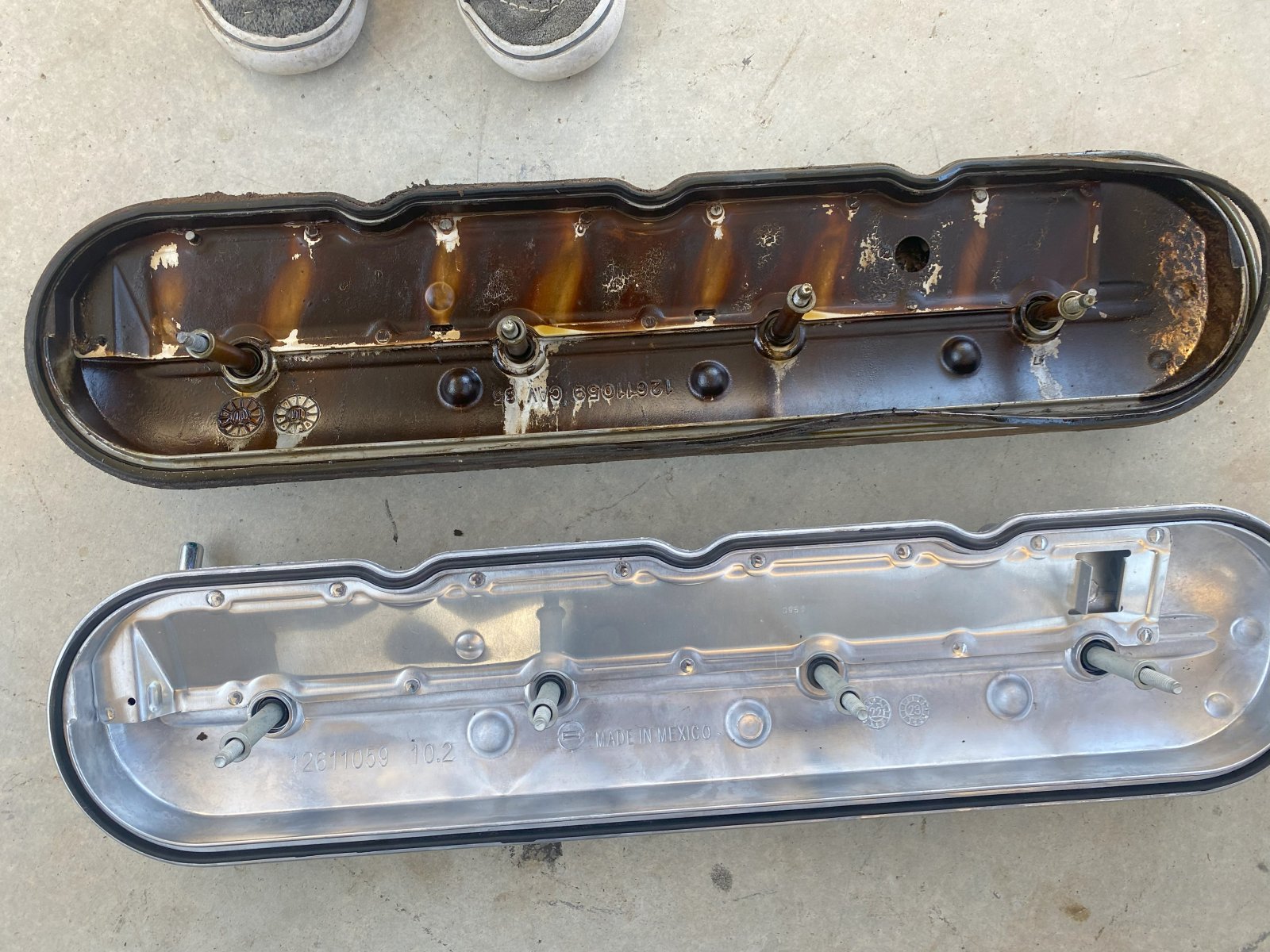

Well, today I removed and replaced the Valve cover with OEM GM part #12642655, per TSB# 10-06-01-008M. My 2011 Tahoe had a build date of November 11, 2010, and it did not have the new improved cover. This would explain why my intake looked like the attached photos. There is really no way to tell if the cover is the new design or old from the outside it MUST be removed to properly tell. I'm hoping that this clears up some of my disappearing oil issues, besides the rear main seal leak lol. Forgot to mention that in the process of removing the valve cover my dumbass broke the plastic hose leading to the purge valve. A small piece of 3/8" fuel hose will serve as a temporary fix.

I installed a catch can in 2018 just before I did the TSB & valve cover. CC was catching 1 oz per 100 miles. After the TSB & valve cover, and still today, it catches 1-2 oz per 5,000 miles.
I left the CC on as a diagnostic tool. If it ever starts catching a lot of oil again i'll know something is wrong.

An Update: before I replaced my valve cover, I would go through about one quart of oil every 2.5k to 3000k miles but now I have no more oil loss. Best investment I have done. If you have an older Tahoe this project well worth investigating.
Yep, that's GREAT! :waytogo:
like I said 6+ yrs ago when we bought our oil burning & leaking 07 Denali and I did the TSB, "if I hadn't seen it for myself I wouldn't believe it."
Ours is still going strong today at 199k miles and doesn't need any makeup oil between oil changes. :893karatesmiley-thu
