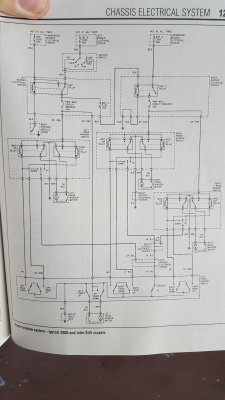

My manual says to check the fuse & circuit breaker. It says there might be also a relay.
See if you can read this Power Window System schematic.
(Update.... ugh.... seems too small to read. ( maybe print it ?)
If someone wants to read it, I could take pics of sections and make it easier to read.
