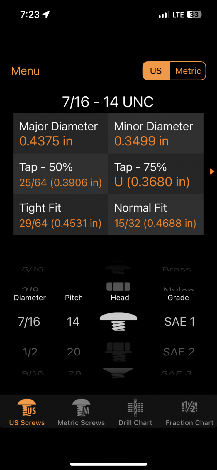

Is a 5/16” drill bit the correct bit to use this hidden winch mount? I saw a YouTube video but I’m trying to verify the drill bit size before I go to the hardware store and buy 2 of the same drill bits that are probably pointless otherwise anyone can post a YouTube video with false information so I’m here to verify the bit size

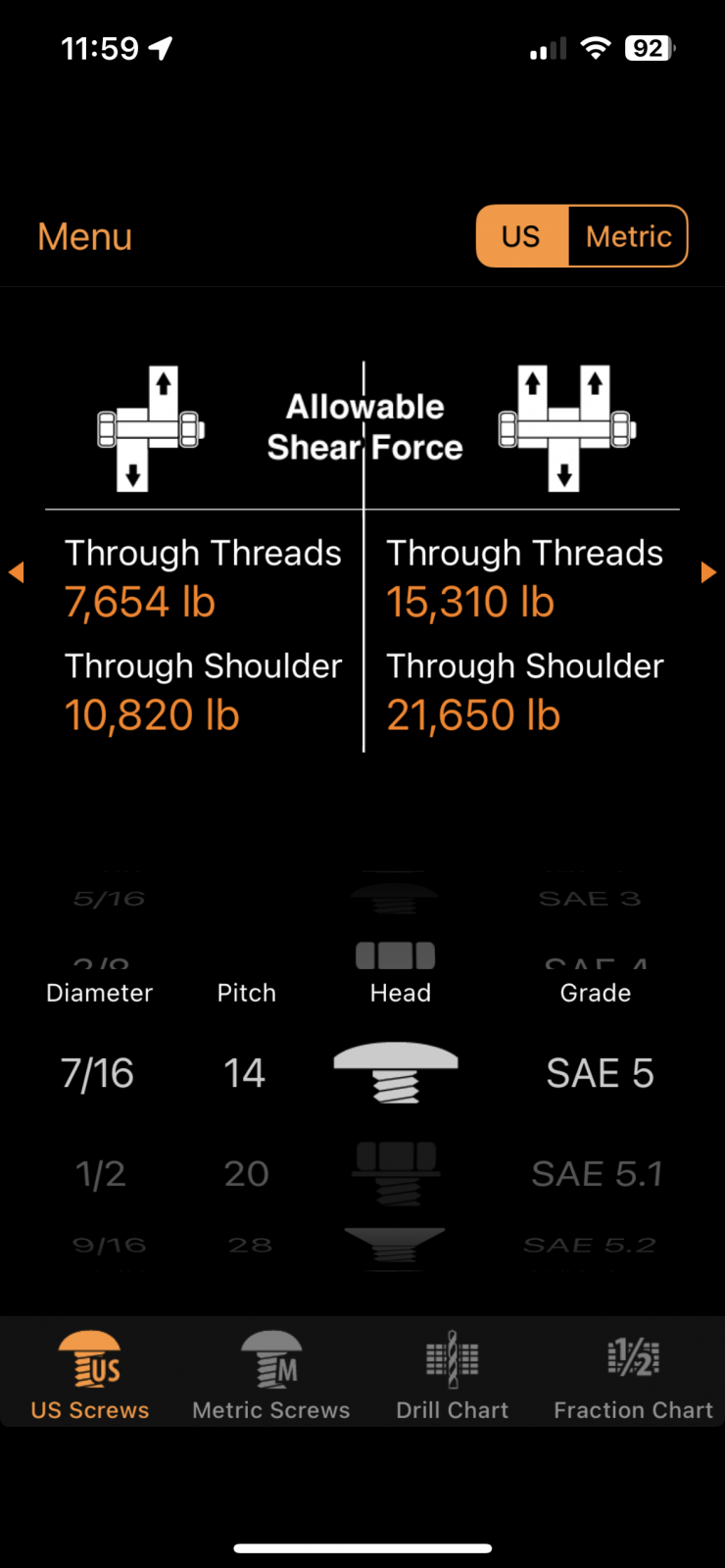

Four 5/16 bolts about 1/4 of strength needed for 12000# winch.

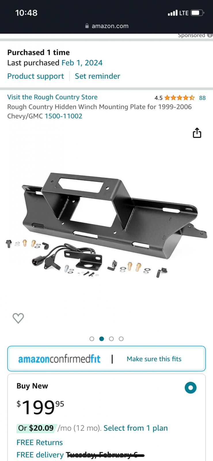

Rough country’s “installation instructions”It comes with the bolts it just doesn’t tell you what size to drill the holes in the frame because technically this kit isn’t meant to go on a SUV model but everyone says it does after drilling the holes are 5/16 bits required for the hole or do I need bigger?

Parts list above shows 15/32 drill bit and 7/16 bolts.

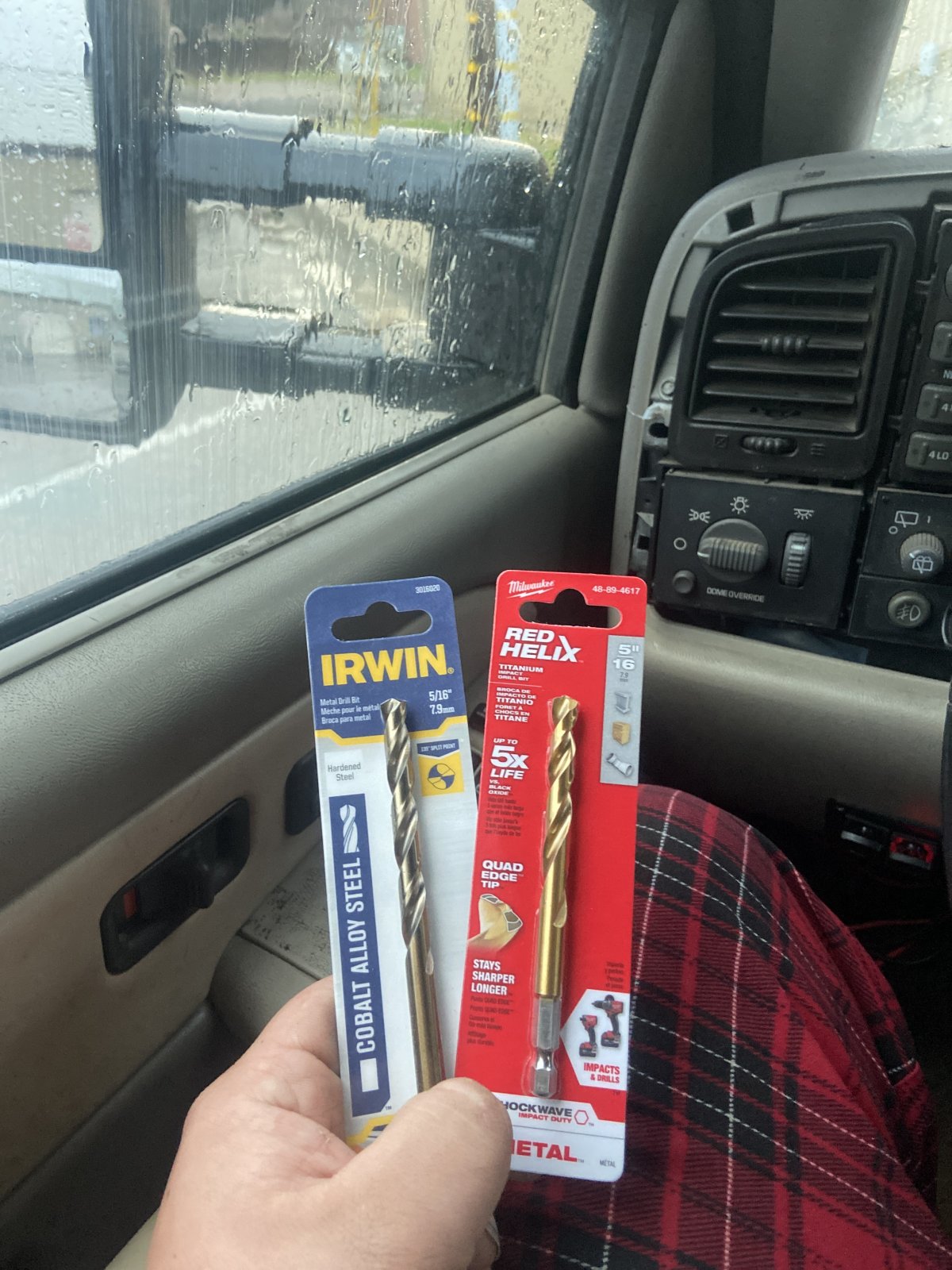

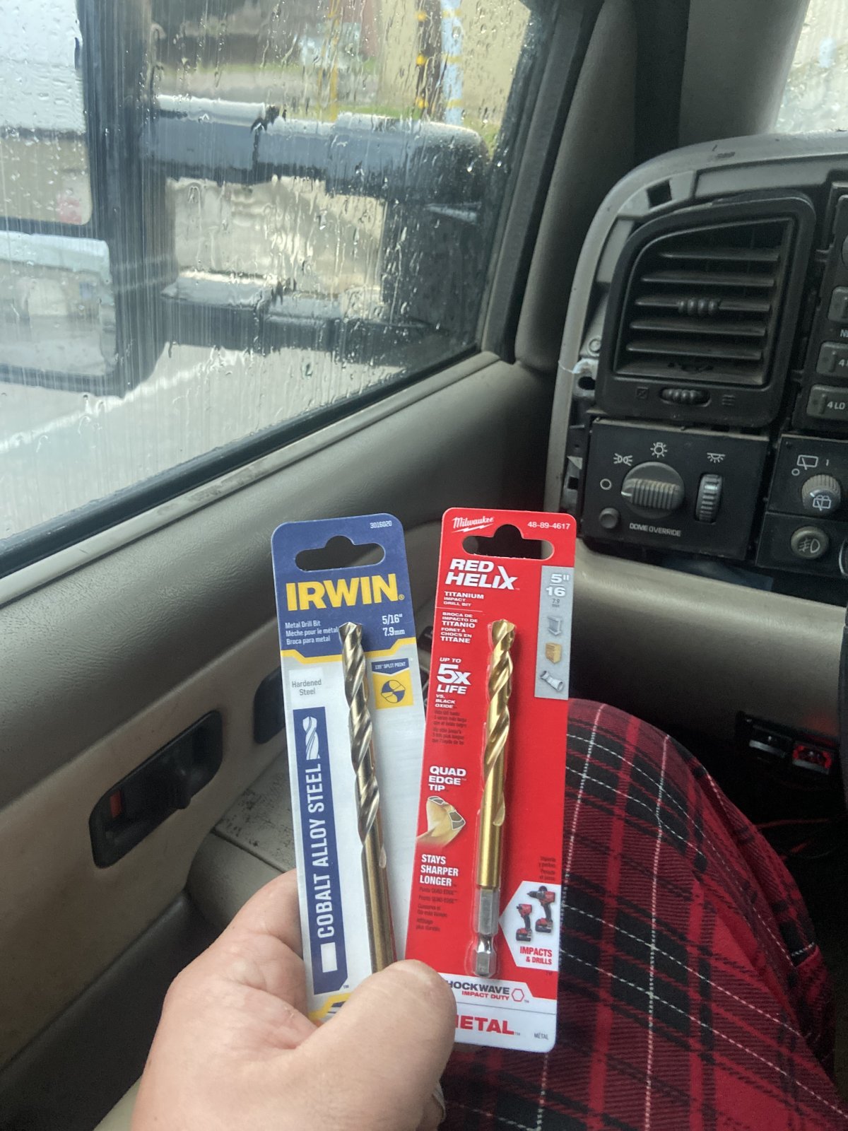

YouTube guy replied and I picked up these2 hopefully they work

View attachment 420415View attachment 420416View attachment 420417

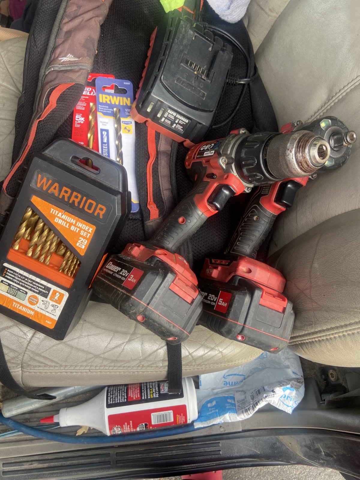

Don't start with those drill bits. Get a p-r-i-c-k punch (another bad word, I guess) and make an indent with it at the locations where you want you drill the holes. Start with a 1/8" drill bit and make your first holes. Then move up in size to a 1/4" drill bit and enlarge the holes. Last, move up to your final drill bit size, and further expand the holes to their final dimensions. You will end up with precisely aligned holes and they will be clean.

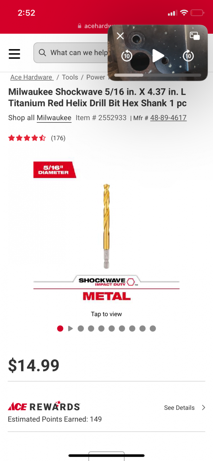

Yeah , I was gonna pilot with a 3-16 (rivet sized hole) maybe a side step between and then send her home at the needed hole size I just didn’t have a quality 5/16 bit, this is what I’m working with

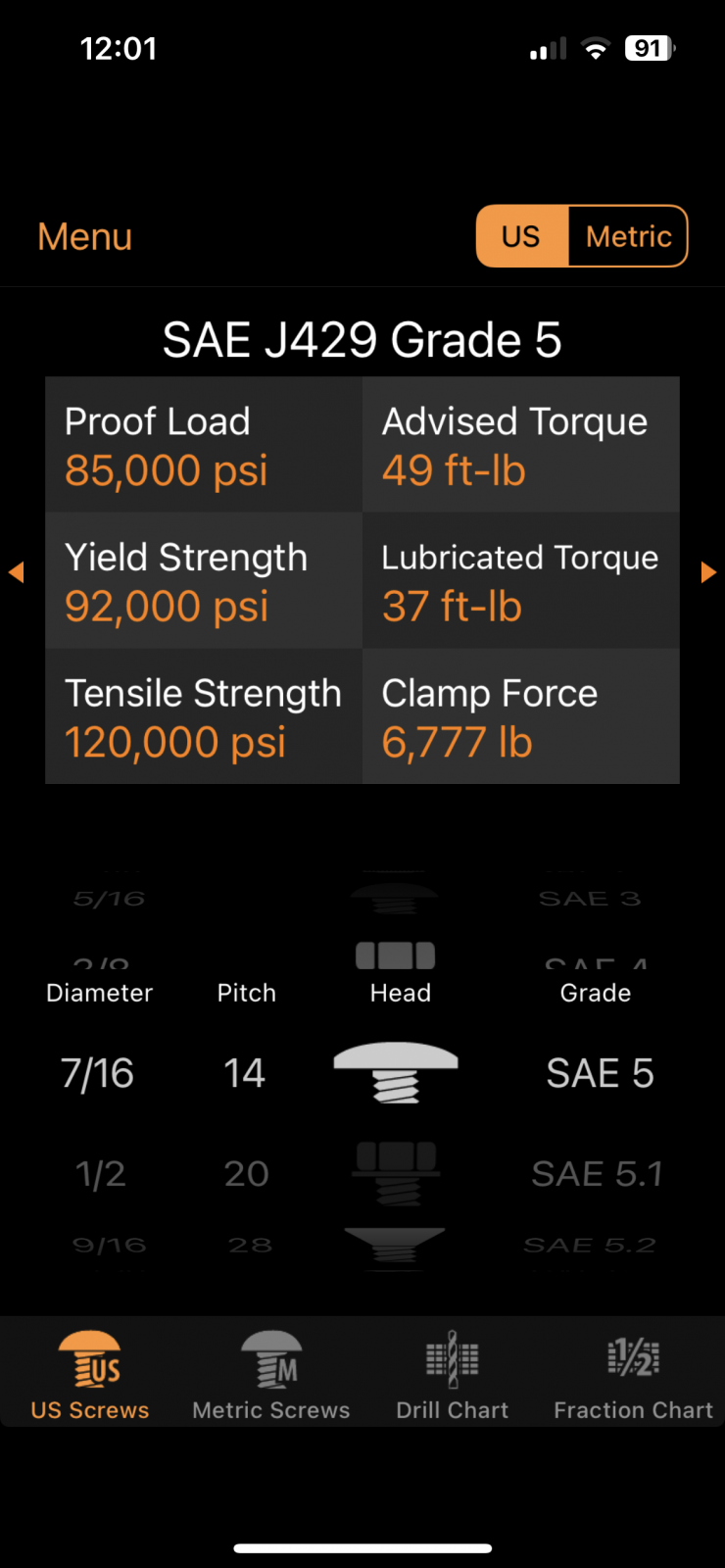

If you have 7/16” bolts, 15/32” is the typical clearance hole size.
I heard one of the reviews say the bolt/ nut combination isn’t a common sizing I believe I have a 15/32 laying around In the kit but I have to drill 4 holes through thick steel hoping it all works out when it arrives

I have a spring loaded punch I planned on using
7/16” diameter hardware may not be common, but it should be sufficient in size. It looks like has a sufficient strength for what you’re doing. If you need to bump up the hole size to 1/2”, you will be fine as well.

It wouldn't hurt to have some cutting oil present. It will save your drill bits.

If I snap a bit I’m probably just gonna jump to 1/2” I have several 1/2” drill bits because of my job
