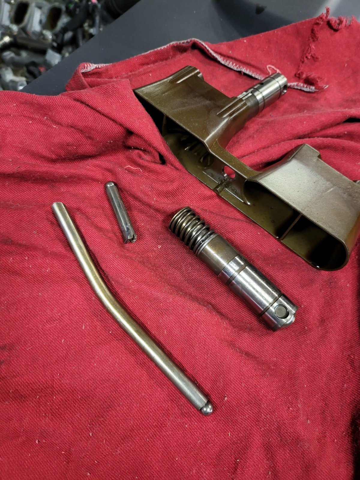

Here's the latest and greatest....
Warranty assholes refused to cover the costs because i didnt have my oil changed at an "authorized repair facility". The receipts i provided wasnt enough....
Went to dealer to see exactly what happened...lifter collasped at cylinder 4 with broken pushrod. No damage to camshaft, but $5400 to fix. $2300 in parts and $2900 in labor...
Those parts look like oil been changed to me no sludge oil won't keep a push rod from bending that's mechanical and not from no oil changes.
There is TSB on this problem and not from oil changes. I would be disputing this.

That's what the tech told the warranty company but they still denied.
