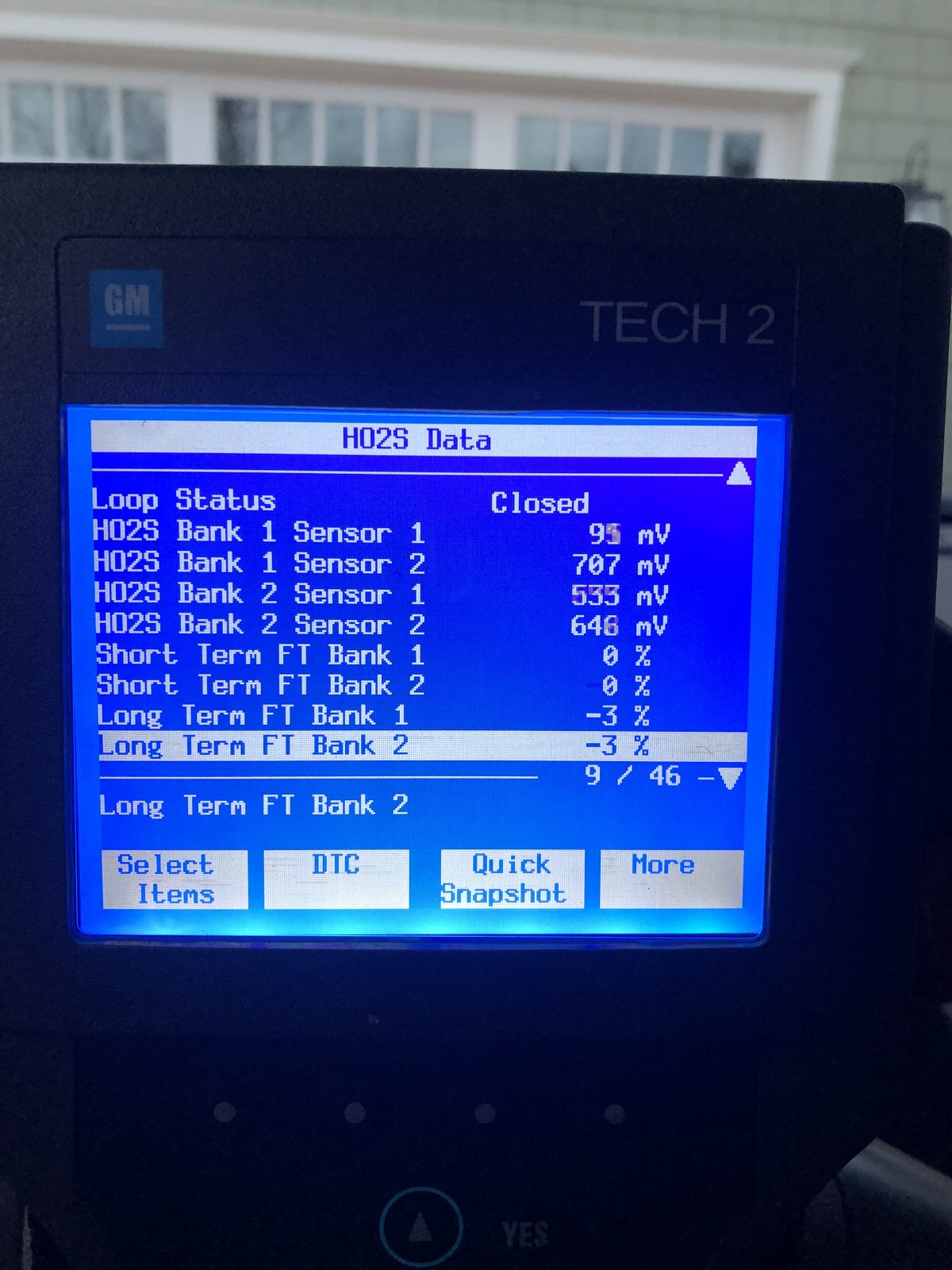

In doing a live data run looking at my upstream O2 sensor readings for the P0442 thread, I noticed when my engine was warming up, the Bank 2 Sensor 2 reading was stuck down low like 165 mV, while B1S2 was sitting up around 750 mV. After the engine (and I assume the exhaust system as well) had warmed up fully, the B2S2 came back up to like 646 mV.
Neither was hopping around following the S1's, so I assume it likely isn't a cat issue and maybe one of the downstream O2 sensors is having trouble with its heater circuit?
Right now, I am thinking of swapping the two downstream sensors and seeing if the voltages moves with the sensor. Any input from anyone who actually know this stuff would be greatly welcome. :)

It is Delco OE, but not sure that means anything as it pertains to DOA. It does seem to respond and reports a similar voltage to the other side once things warmed up.
The picture above was after the engine coolant temps had gotten to normal operating temps. During warm up, it was reporting a solid 160's mV.

As @kbuskill suggested, I spent some time with the Tech 2 and the O2 sensors this morning and the heat circuits seem to be working as designed, all four heater circuits reported a similar amperage draw.
My conclusion is that as @Tonyrodz suggested at first, one sensor must just be a little slow. After getting up to full temp and running the engine above idle in cycles, both number 2 sensors are reporting very similar voltages and track throttle applications.
I may swap in one of the old downstream sensors into Bank 2 position and see if it responds a little more quickly during the warmup cycle, although it appears the new unit works fine after the engine gets warm and is in driving mode. This last bit will be just for my own edification.
