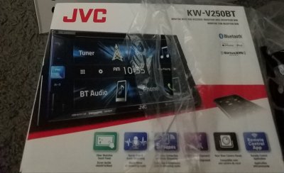

It's not the most expensive and best double din in the world but just the feeling to have bluetooth was enough to convince me to buy this . I currently have the stock radio and a cassette tape with the aux wire and it's just a hassle . But this would be a major upgrade.
