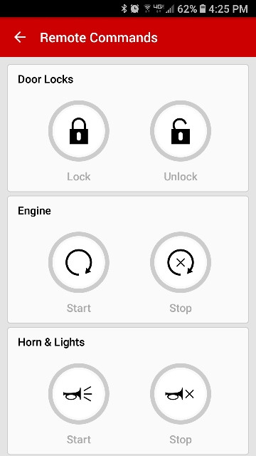

Momma did it! I leave a window open but have Onstar. You guys with the 2010+ can open them with an app on your phone.
Hello, could anyone please inform me about the app to unlock your Yukon / suburban with your phone ??? Thanks.
Apr 11, 2018
7,124
14,375
St. Louis
MyGMC app has a keyfob screen and uses Onstar to lock/unlock, remote start/stop, and honk horn/flash lights.
You can also use apps like GMRC and obdCANex that will connect to a Bluetooth MX or MX+ obd Scantool adapter to do those things, but have to be within Bluetooth range.
Here's a pic of the MyGMC app keyfob that uses Onstar
