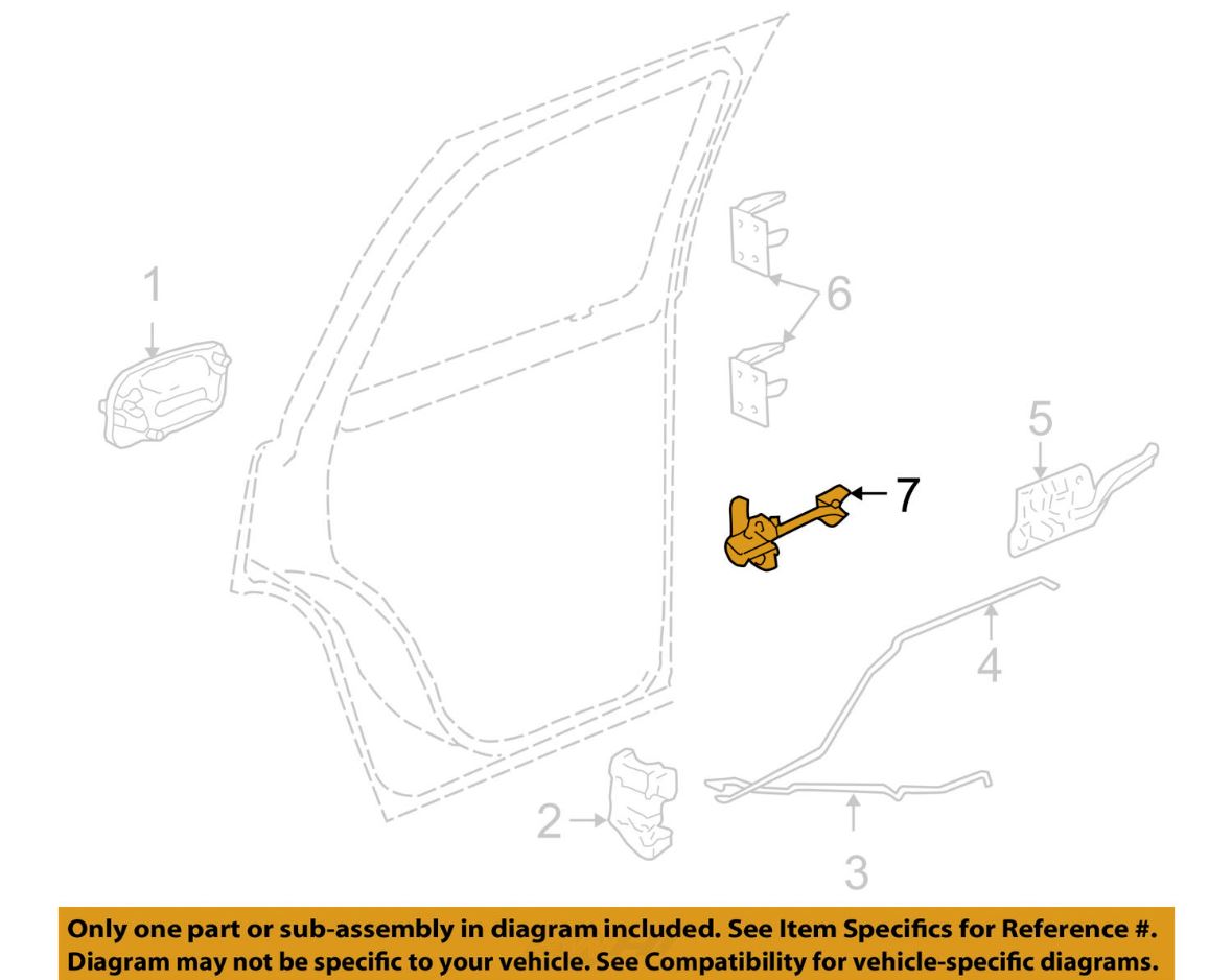

Driver is most used so that little wheel has to be worked with grease and a screwdriver or replaced total. Mine does exact same.
30,552
48,016
99% likely it's not the hinge it's the door check/stopper, they wear out and make a lot of noise, grease is only a temporary fix
