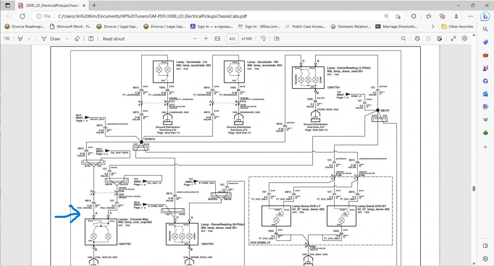

I'm not so good at reading these GM wiring diagrams, but looks to me like you can disconnect orange wire (A)?
Map lights should still work..

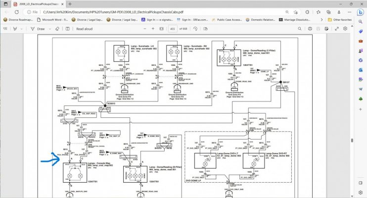

---------------- CORRECTION EDIT ------------------
Green-Yellow wire (B). the diagram shows the front dome switches switched on, I believe it is the GREEN-YELLOW that is controlled by BCM..
Thanks but it may as well be in Chinese lol

Unplug your front dome light and disconnect the green-yellow color wire.
If you do this, nothing will turn on the front dome light, except for the buttons on the light.
If no understand, I no can help.
mikez71
Mar 9, 2023
3,219
3,985
Actually.. I believe it is the GREEN-YELLOW wire..
Orange is power for switch controls
So try the Green-yellow..
The diagrams threw me showing the switches flipped on instead of off. (while all other dome lights are shown switched off)
Also, if you do unplug the wire, please make sure to tape up the end so it does not short!
