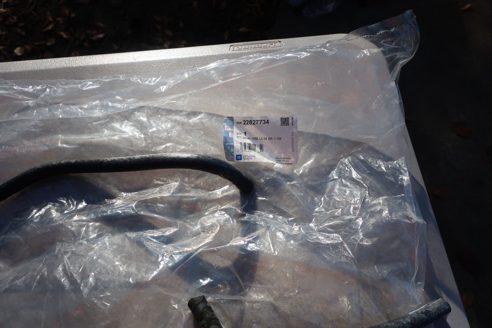

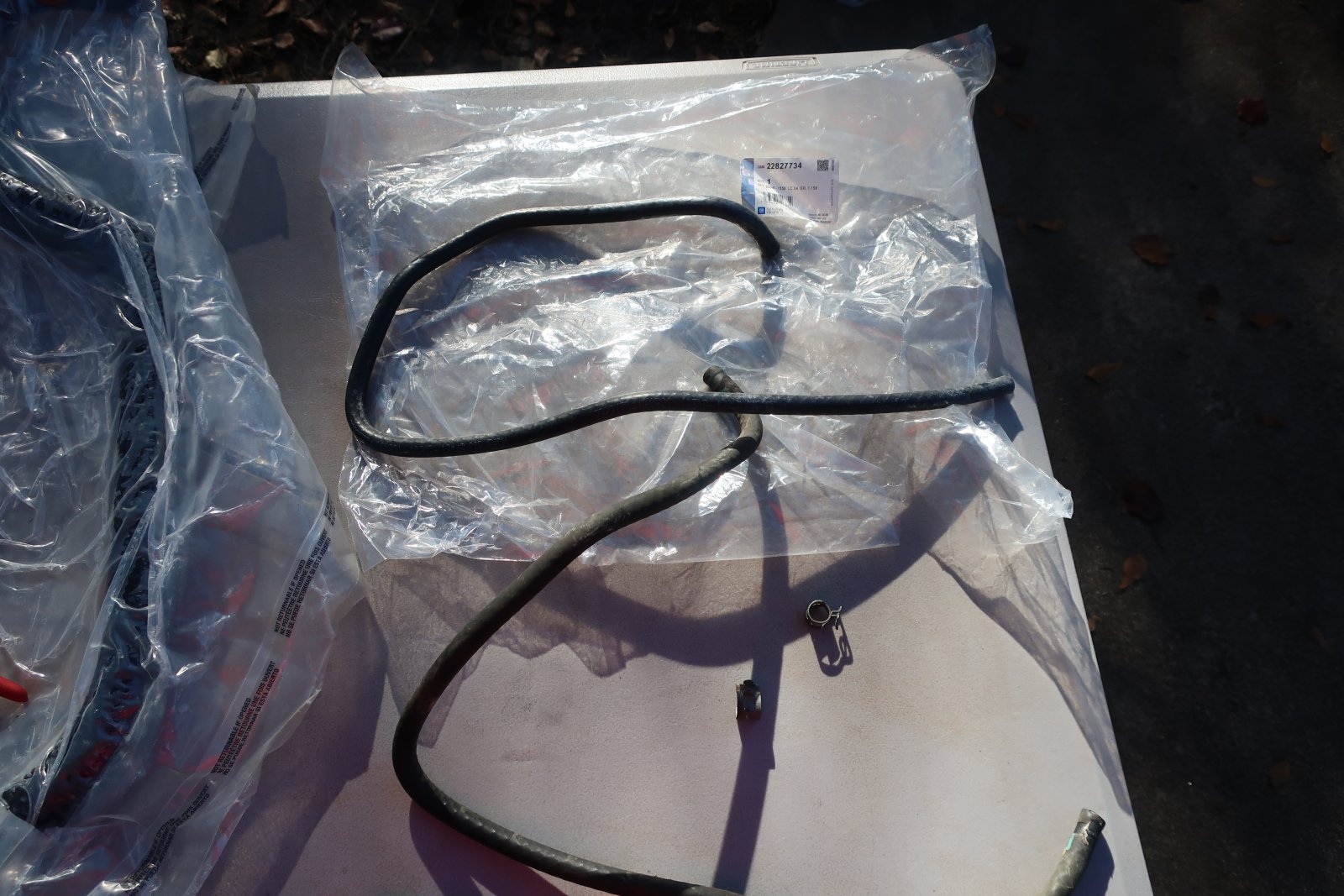

I believe this is the hose you are looking for.
Yep, that's it! I see now that it's a molded hose, not just a length of hose. Thanks!

Nope, this one is coming off the head and goes towards the radiator. It's not the hard line between the heads.
You are quite welcome!
GM Genuine 22827734 is around $37, Gates 18126 is around $17, on Rock Auto.
