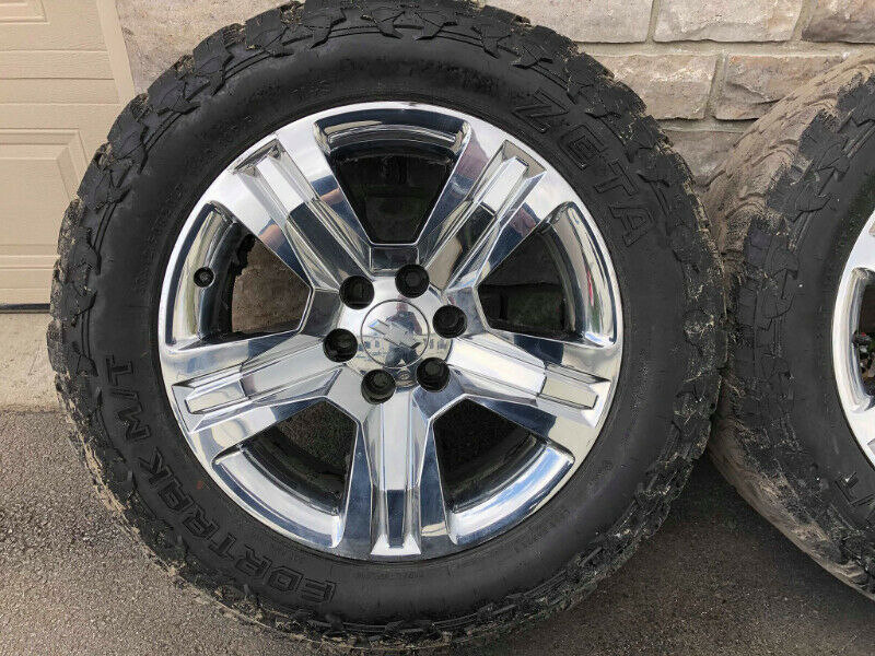

Hi,
I found this nice wheels & tires package that came off a 2016 Silverado; however, since the tire size is so different I would like to know it they would fit my 2016 Suburban before buying them. Can someone confirm; see the details below:
Wheels: 20" Stock Chrome Wheels from a 2016 Chevrolet Silverado
Tires: Zeta Fortrak M/T LT33/12.5/20
Thanks in advance
Here is a picture
F
flagnation
Apr 21, 2019
19
Ok so if I understand the tires wouldn't fit. If so, would it be a good idea to buy smaller tires to make it fit or not recommended? Thanks
