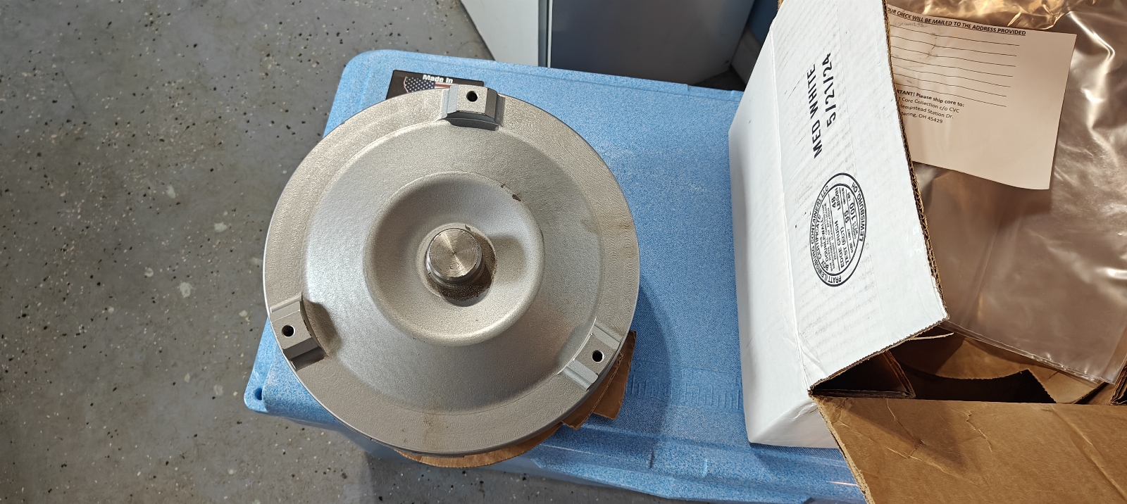

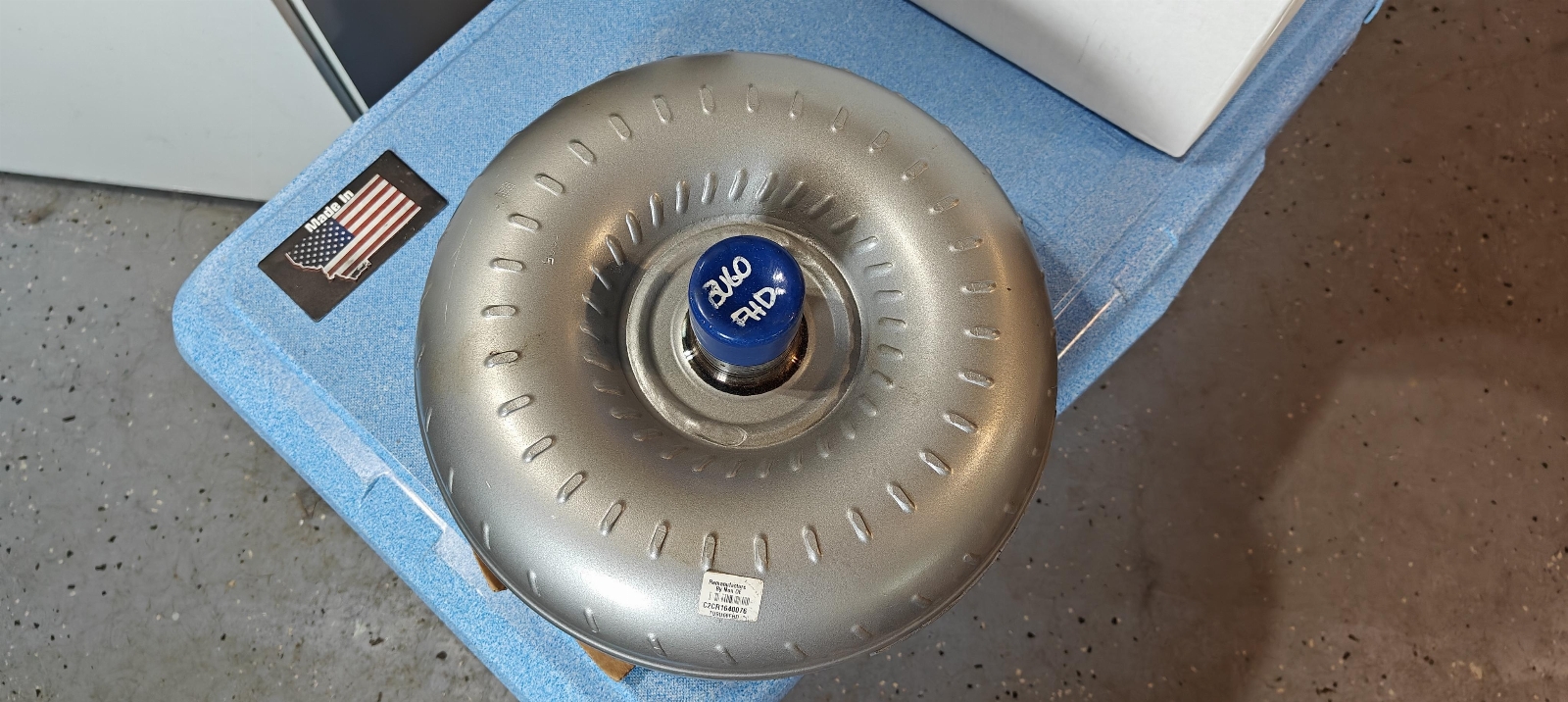

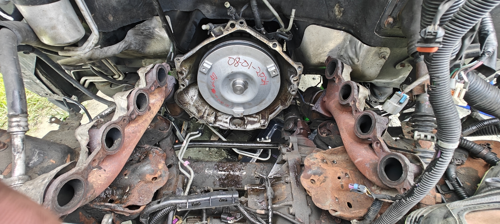

Picked VEGE reman BU60FHD. I hear they have the billet cover, etc...what do you think ? Have not pulled trigger on these parts yet !
I just installed the same converter in my Yukon, but waiting on a cam adapter to be able to fire it up and (hopefully) drive it. I'm curious if there's any difference to the JMBX with 179k on it. There is a billet rear cover on it.
