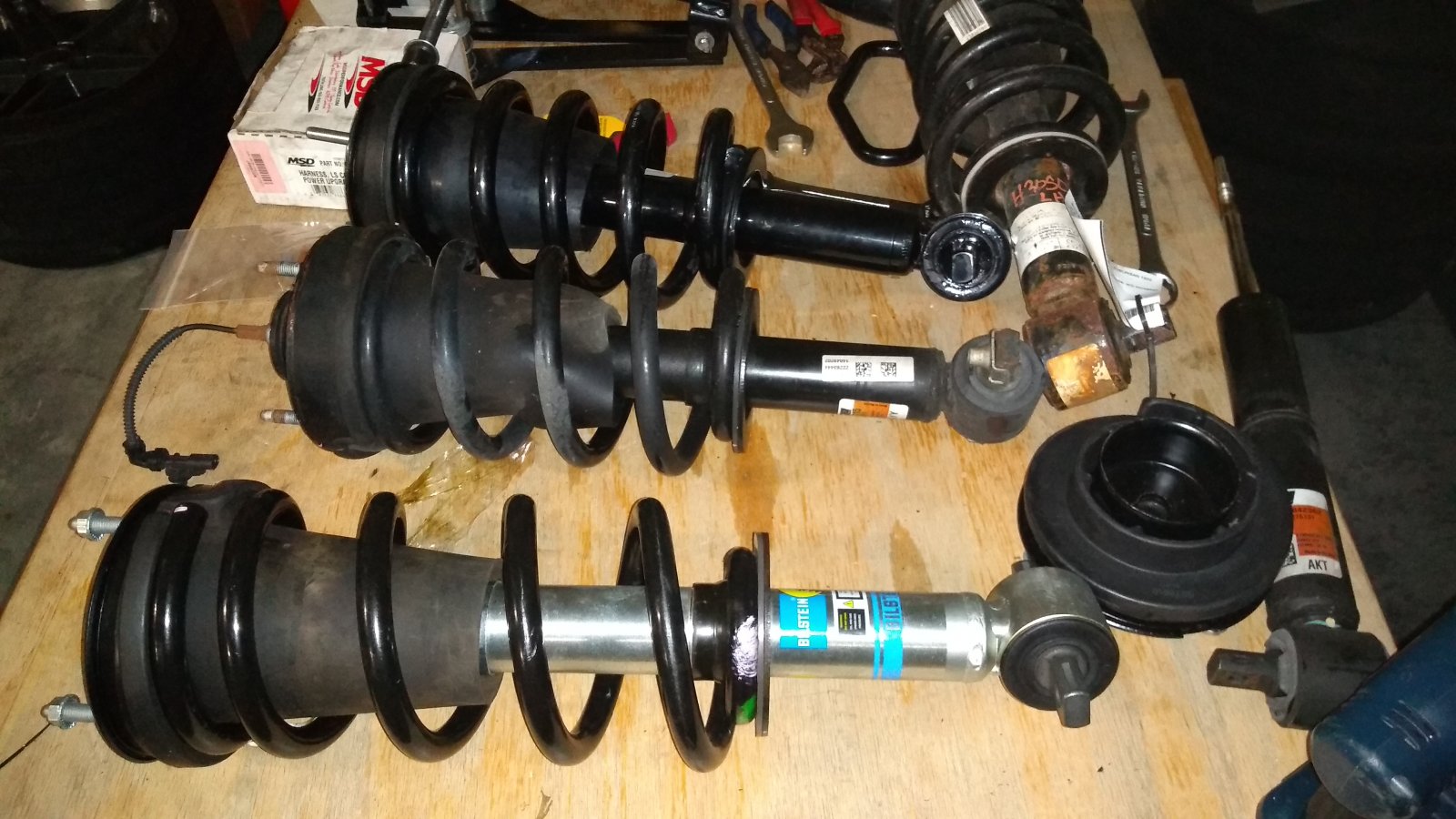

We are working on something, still quite a bit away from completing full testing.
Bilstein 5100 (PN 24-251976) on 2015 Tahoe LTZ
It will require a different top mount, but hoping to reuse the lower spring mount, isolator, bumpstop and spring.
We will keep you updated.

Max, I talked to RDT Diesel. I forgot his name) and he commented on using the stock MRC parts with new after market shock is doable but the modifications to make it work was not a cut and dry task and suggested to use stock Non MRC parts. He couldnt comment on the spring rate and functionality difference but didnt think it was a big enough factor to worry about.

@Dearmosd That is the way I understand it as well. I also agree with the assessment about the spring rate.
There are many different springs available. Just enter your VIN on any GM Parts site and look at the options.
Here is the GM part number for the upper mount with the non magnetic diameter for just about every 2014-2019 truck/SUV.
2014 thru 2019
https://www.chevroletpartsdirect.com/oem-parts/gm-strut-mount-22826284
  • SKU:22826284
  • Positions:Left, Right
  • Other Names:Mount
  • Description:
    Tahoe, Yukon, Escalade. Yukon XL, Suburban. Escalade ESV. Sierra, silverado.
    Without magneride. 2wd, without magnetic ride control. 4wd, without magnetic ride control.
Then fit your stock magneride spring over a non-magnetic shock core of your choice.
Bilstien, Belltech, AC Delco, etc
We just haven't tested it on a vehicle yet, perhaps after race season is over. :)
