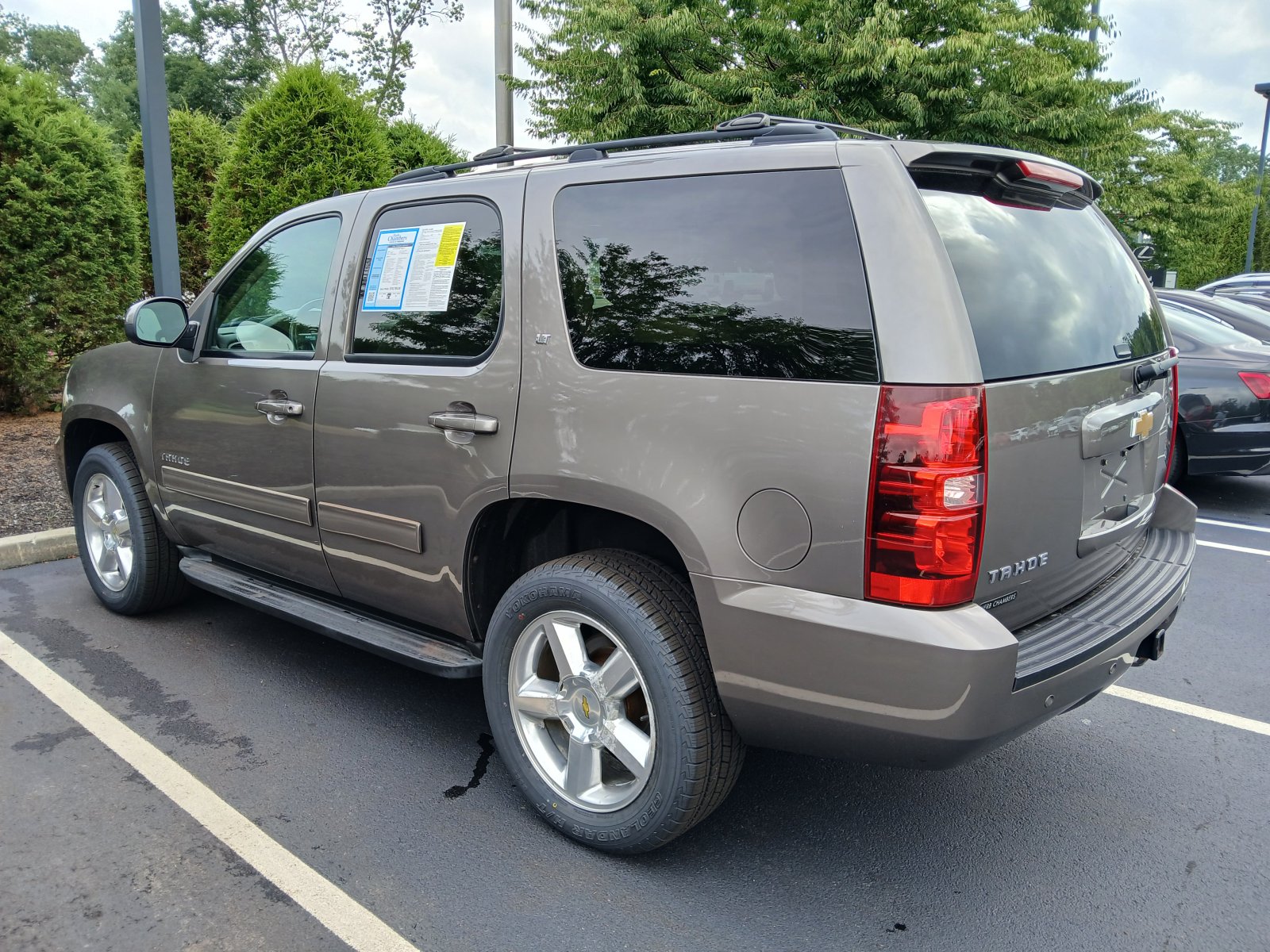

Wondering if these flat plastic trim pieces come off easy (onthe 4 doors).
Kind of worn and would look better without them or at least take them off to paint...

Yes, they come off. Easy? That's debatable. They're held on by a strong double-sided foam tape.
Removal is a two step process...
1) Use fishing twine to get underneath the piece and cut the foam. This will get the piece off the door.
2) Remove the remaining foam/adhesive. This takes PATIENCE. The adhesive will come off, but it's a slow and tedious process. It can be rolled back with your fingers. It will come off cleanly, but it's slow. Some folks will recommend the 3M eraser wheel in a cordless drill, but you have to be really careful about damaging/overheating the paint.
You can use something like Goo gone to help, but I found that just made it harder to roll the adhesive off. I just used my fingers. It took a few hours and my fingers were sore.

Can you tell me if they sit in a recess or is the door shape uniform? (Will the door look OK without them?)

Looks like there is some panel work needs doing on the doors too.
Is that a crease through those panels?
I looked at the truck yesterday and there were no creases in the doors, maybe the pic? ....Or I missed something. The dealership was good enough to put a new hood on it, paint it and fix and paint the other side where the plastic bumper cover meets the rear fender. The rest of the body is really nice for 11 years old...

I think you can remove them like an emblem. Use a piece of fishing line holding above and below and with a "sawing" motion use it to cut/separate the double sided mounting tape. Then use a 3m Adhesive Eraser wheel to clean up the left over tape residue. Wash/wax when done.

I have used these plastic razor blades in link on the double face tape before and with goo gone worked fine. Then used eraser wheel on drill to clean everything up worked fine.
Buy the good plastic blades I have bought some on amazon and they didn't perform the best.

I took the rub rails off my 2011 about 2 years ago - truck is white and it turned out great if I do say so myself.
To add to what 'intheburbs' said about the process, I did use the 3M eraser wheel and it worked like a charm. But to their point, you cannot press ******* it - let the wheel do its thing.
After all the goop from the 2-sided tape was removed, I used Griot's Fine Cut Polish to even everything out and then their ceramic to wrap it up.
It's definitely a process, but to me it was well worth it.
