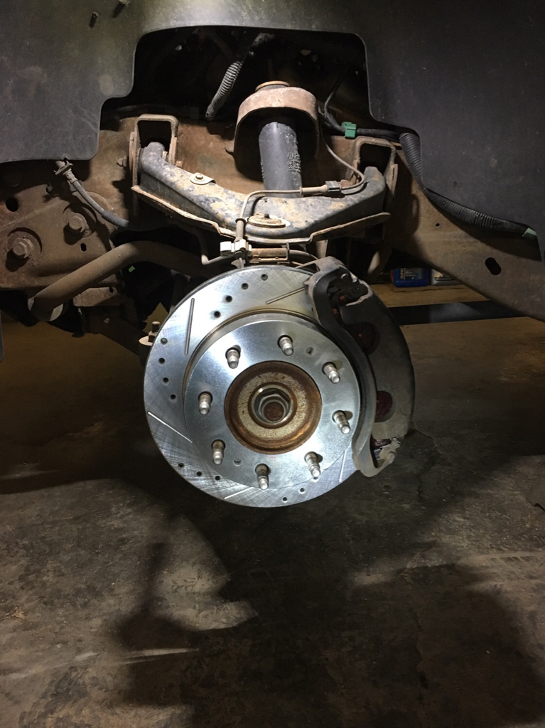

Do you NEED anything heavier duty than stock? Probably not. If you’re going to spend the money, why not upgrade?
BrakeMotive on eBay, right around $100 per axle for ceramic pads and drilled/slotted rotors. They send “House Label” pads but they are unlabeled PowerStop.
I pulled my Jeep to KY last weekend and had to do a couple emergency stops. The truck brakes worked flawlessly and didn’t fade through mountain driving. This is the 3rd or 4th vehicle I have used BrakeMotive parts on and I have always been impressed.
Are they dusty? See the finger swipe below; that’s after 800 miles of towing. Could be worse.
