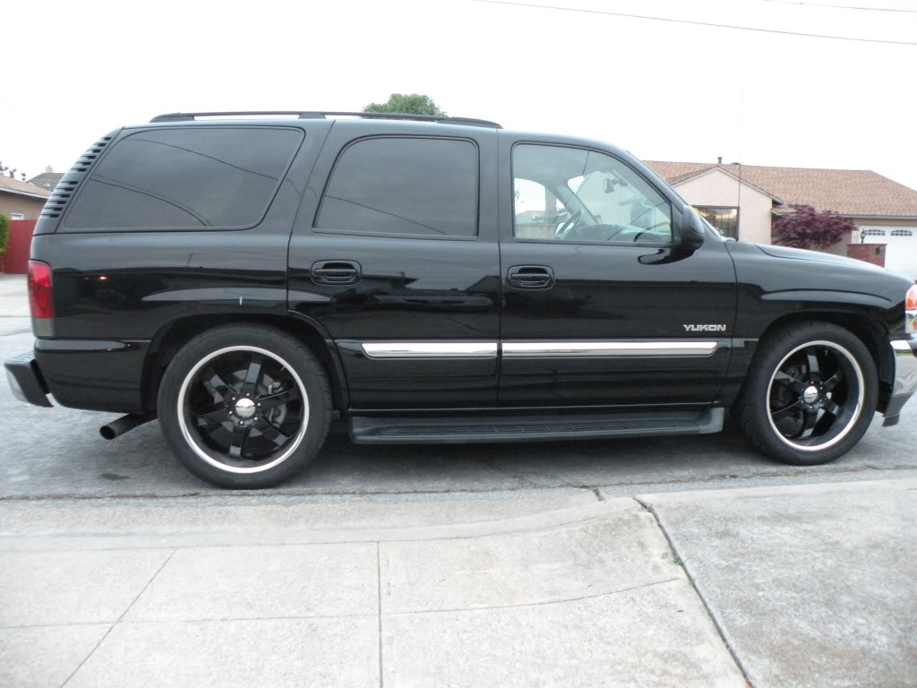

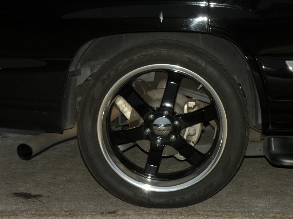

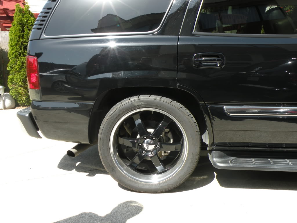

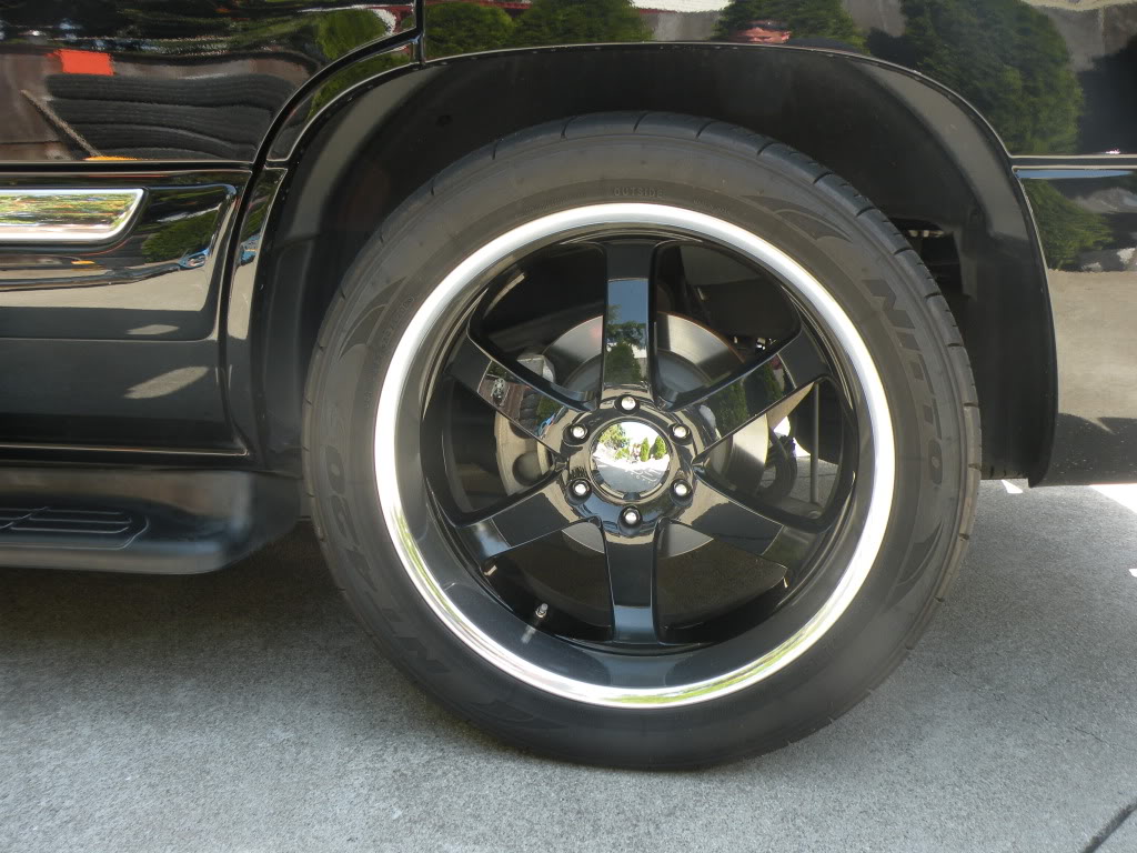

So, i have about 75miles on the springs and they have lowered the truck about 1/2" from were i was prior with the DJM 5" springs. Right now i sit at 32.75" inches from the floor to the fender. Will need to let settle for a while before we get a accurate measurement.
Before
Springs compared
After 75 miles of driving

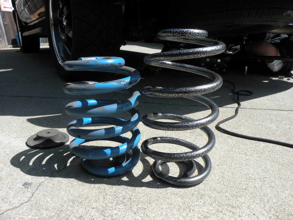

The drive is so much better now. My wife took the truck to work today cause i had to work on my moms car, and she said that she can really tell a difference. You can tell in the pic with the coils side by side, that the DJM 5" yukon coils (blue) are a lot thicker as far as the winding in the coil goes.

No spring isolators and the ends of the trailblazer springs are tighter which is no problems over the past 8 years of using trailblazer springs on my customers trucks.
