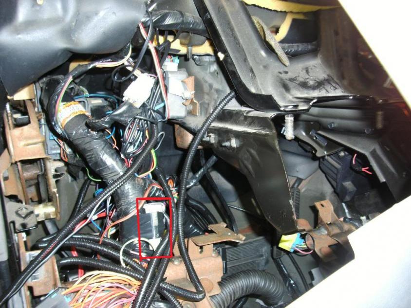

19 tahoe 97
Dec 26, 2012
94
Where is the "DRL Module" !!!
I looked for it every where!!
If you sit in the driver's seat and look down by your right knee you will see a bulge. (in this picture bulge appears to be above the brake pedal)
If you look under that bulge there is a small black box attached to a bracket with wires coming out of the top. pull off the box and unplug the wires and that will disable the DRLs. You may need to use a flat head screwdriver or needle nose pliers to get the box off the bracket. removing this box has had no effects on other lights or systems that I have noticed and my brake light still comes on when I put down the parking/emergency brake.
