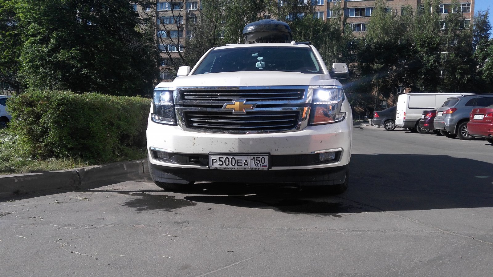

I don't understand a little. DRL and dipped beam are different headlight units. DRL is a diode strip that separates the near and far blocks of the headlight. and Low beam is the upper headlight assembly. Do you mean that the strip of diodes does not get brighter or dimmer when switching to DRL and Low beam?

Hmm, I just had a Tahoe 2015 with a diode tape. Here in the photo the dipped beam is turned on forcibly. but the diode strip is also visible. Accordingly, in the DRL mode, only the diode strip shone, and the low beam was turned off
