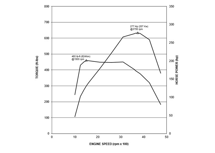

Here is the HP/torque curve. Put it on a dyno if you’re so concerned. Numbers won’t lie.
