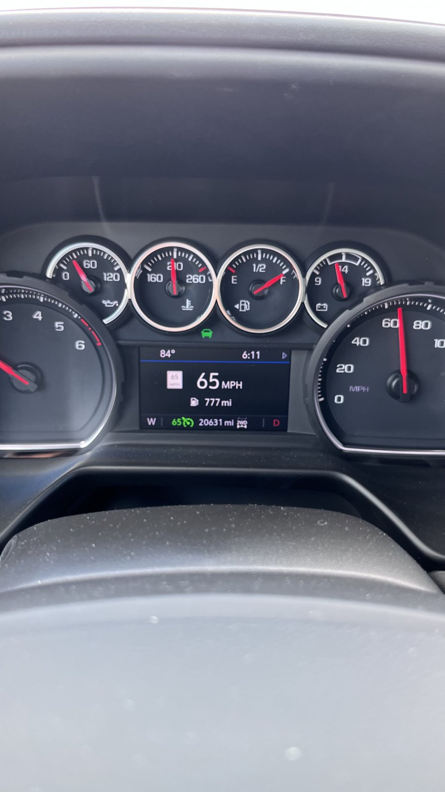

Didn’t change fuel type.
I drive it about 1000 miles which I did it more than 10 times in the past and filled the tank from the same gas stations. But the results are not favorable.
With a full tank I could drive around 767 miles and now it’s around 550 miles.
I’m not sure if they did any engine calibration, but definitely I feel it has more power and I can’t hear it’s turbo noise.
If anyone has any recommendation regarding the engine calibration or anything that can help I appreciate it to share.

Your 24 gallon gas tank is averaging 777 miles? That's over 30mpg! That's crazy! I get 30mpg average on highway around 80mph.

This is true. I pretty routinely see that screen say 495 to 505 miles available after a fuel up on my xl with a 5.3 and it does not get that many miles no matter what you do. Those numbers drop almost immediately once you start driving. I've never actually calculated it but we probably get a little over 400 miles on a full tank based on my lifetime avg of 17.5 mpg

Thanks Guys for all answers.
Yes, I have Tahoe 24gl diesel.
I’m using it for the long trips not at all in the city.
And after some research I found, GM released another update in Feb 2023 that changed the previous vehicle parameters.
After another trip I found my mpg get much better than before.
I believe after every update, the vehicle will start to learn the driving parameter and adjust the mpg based on how you drive your vehicle.
