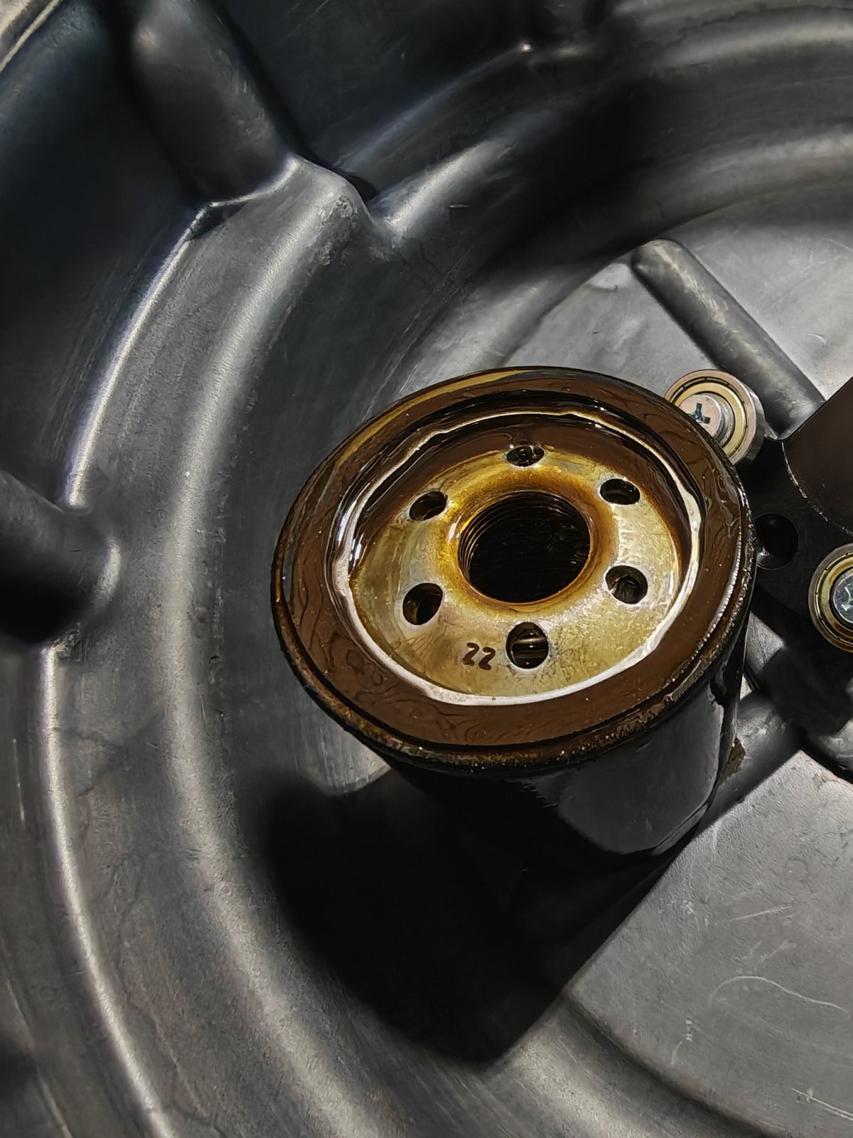

I cannot say this plays into the problem 100%, however, I do have some suspicion that the oil filter restrictions can play into oil starvation on the 6.2l with the 2 stage electrically controlled oil variable displacement oil pump. If the oil filter is restrictive the variable displacement oil pump will back off and reduce the amount of oil supplied. Additionally with the DFM using oil to collapse the lifters and the rod bearings being dead last in the oiling path, this all adds up to be a very questionable situation.
There clearly are more larger oil inlet holes on the AC Delco OE filter than almost all of the aftermarket filter. Even when compared to the AC Delco Gold filters. There is a reason for the 13 larger oil inlet holes in the OE filter, but why?? Weight for fuel economy or reduced restriction for better oil flow?? Is this for the ASS system and quicker oil pressure build up?? Only GM knows, but not sure I would want to run either the AC Delco Golds or any of the aftermarket filters.
OE AC Delco Oil Filter bottom view
Puraltor Oil Filter bottom view
AC Delco Gold UPF63R

So you're saying, the two factory filters have less restriction because the GM knows the engine needs less restriction vs actually filtering out particulate?
jfoj
Aug 9, 2012
1,217
1,074
No, what I am saying is the oil filter base plate on the AC Delco PF63 has 13 large inlet holes. All the aftermarket filters and the AC Delco Gold filters have far fewer and smaller oil inlet holes stamped in the baseplates. Why, only GM knows?? Are the larger holes for better oiling on cold start? Faster oiling during ASS? Something to do with the variable displacement oil pump?
Sure there have been many 6.2l engine failures with the OE PF63 as well, but I am not sure I would ever run a AC Delco Gold filter with the 6 smaller inlet holes in the baseplate. Question the aftermarkets as well.
There is also a difference with the size and number of oil inlet holes in the filter baseplate than the actual filter media. Just figure the square inches/opening area of holes in the filters with the 6-7 inlet holes vs the 13 larger holes on the OE PF63. This could act as a restriction before the oil even gets to the filter media.
20-30 micron particles should not be taking out bearings on any engine, this is pretty much the standard for years. The majority of these engines are failing due to oil starvation at the very end of the oiling path, lack of proper pressure and volume to sustain a proper oil wedge along with oil that is too thin for the torque loading. These engines put out as much HP/Torque as the 1970 427 Chevy motors at much lower RPMs and these engines are loaded to almost 100% torque loading quite often at below 1500-2000 RPM. They are constantly being operating in a "Lugging" mode. The 2nd stage oil pressure solenoid is triggered based on RPM (3,000 which the engine rarely operates at or above except in extreme acceleration conditions), not Load, big mistake. Need to find out if the solenoid can be bypassed without constantly triggering a CEL/SES/MIL.
