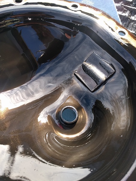

Same truck here, 2011 LT, 80kmiles. Did both diffs 5K ago, used Mobil 1 "Synthetic Gear Lubricant LS 75W-90 Limited Slip Friction Modifier Included" for both Rear:4.2pts and Front:3pts. G80 also.
Here was the condition of the rear with a little metal fuzz on the magnet. A little fuzz on the front drain magnet also:-

Yup, that's almost identical to how mine looked. I went ahead and ordered 4 quarts of the AC Delco 10-4016 75W-90. Sounds like plenty of people are using this for both ends. I'll skip the friction modifier unless I start hearing chatter. New U-joints arrive tomorrow so I'll slap it all back together and see if my original issue is any better. If not, it's on to the front driveshaft/u-joints and diff. I need to check for broken motor mounts as well, but I haven't had any clunking.
