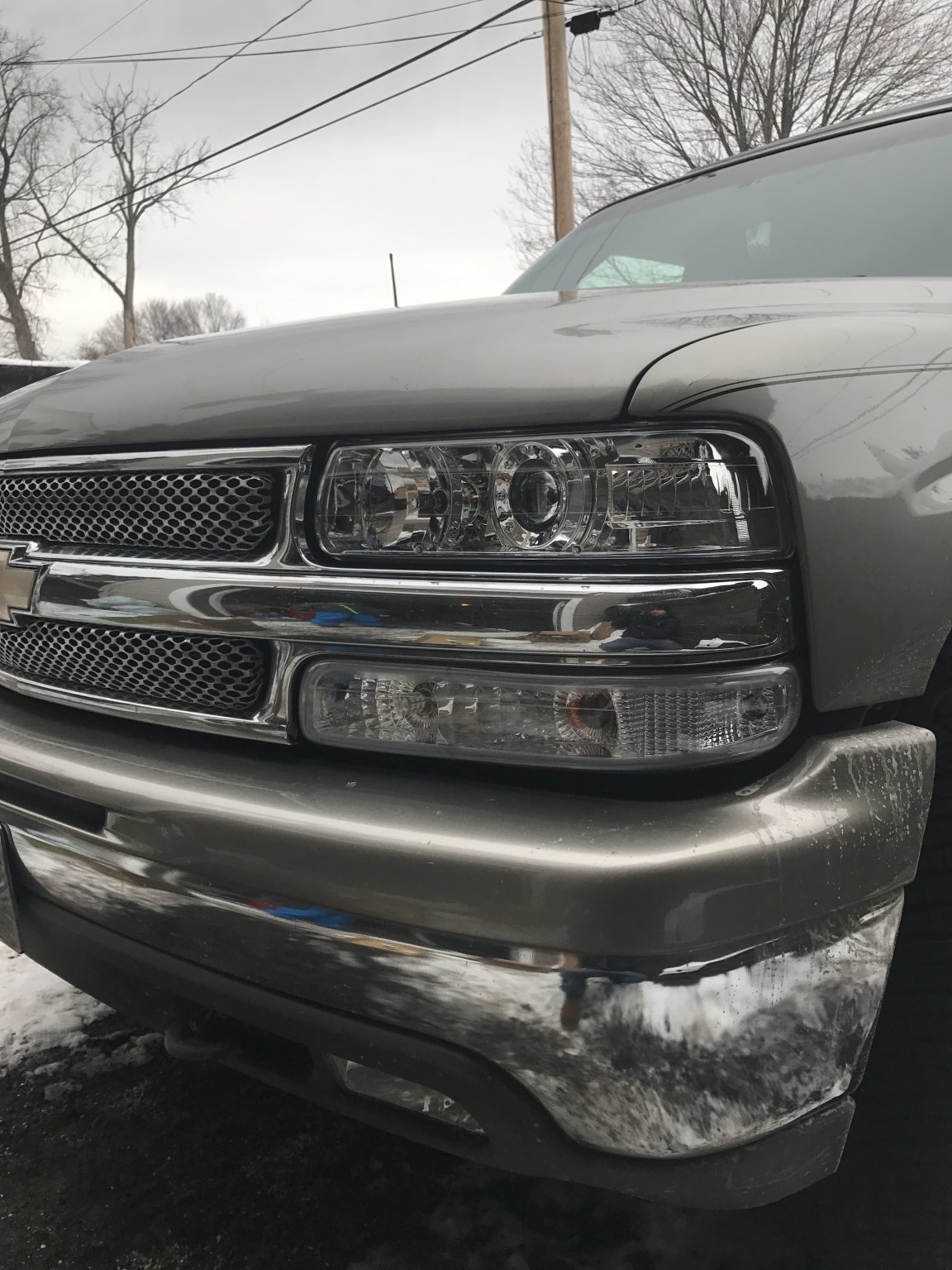

Hello everybody, I see that many people talk about the depot projectors but there's not actually a thread for them specifically. I did a ton of research and chose them, finally they arrived and after installation I'd like to give my opinions.
First!- They're fukcing beautiful. Seriously. The whole assembly feels so quality and the face is GLASS unlike the cheaper units. If you want HIDs (like duh who wouldn't) you have to get projectors. The hid bulbs in a halogen reflector housing will produce a ton of scattered light that will blind oncoming drivers. If you want to be THAT douche bag fine go ahead and slap in that pretty little 29$ eBay conversion kit and blind everyone. But unless you actually are a douche bag, knowing you're blinding everyone will get old quick and you'll go looking for a solution. These are it.
Second!- Some people complain of shaking when going over bumps, well shut up they're just fine. You probably only notice any movement because the sharp cutoff. The frame is good quality and the holes for the pins align perfectly so I'm not sure where the play is.
Third!- They're the only out-of-the-box projectors that work perfectly with HIDs and won't melt. They do come with standard halogen bulbs (9006 low, 9005 hi) which I hear are fine but I bought a quality 5000k 9006 55w kit and it's glorious.
Fourth!- YES a retro will produce a slightly better result BUT unless you're a perfectionist (nothing wrong with that) these really are very good. There's a thread on here that shows the whole process, you can compare pics of output and cutoff.
Fifth!- I went from stock, to stock w/ HIDs, to clear aftermarkets w/ HIDs, to these and I really wish there was a thread like this then I would have skipped right to these. Anyway, the glass housing is gorgeous AND they utilize the standard adjustment points so you can install them and adjust with a 4mm and long extension right through the standard adjustment holes. VERY EASY. MUCH better than others with plastic housings and weird adjusters that you have to remove-adjust-reinstall.
Anyway, I just wanted there to be a straight forward informational about these specifically. Oh, and you'll want to do a 4hi or 6hi mod specific to your year to preserve the bulbs.
Thanks, buh bye!

Good. I'm glad you like your depos. I have to make a couple corrections here. The lens is not actually glass. The lens on projector itself is, but not on the housing. Also there is a substantial amount of improvement with a true retrofit. Not just slight. I have a pair of depo denali projectors, mini h1, fusion fogs, and acura tls. By far the worst usable output is the depos. Now they are way better than factory reflectors...
Also if you retrofit mini h1 you gain bixenon.
26,678
52,943
As for your third point, that "They're the only out-of-the-box projectors that work perfectly with HIDs and won't melt." Totally wrong there. I've been running 55 watt HID's in my Spyder projectors for over a year with no problems. They also have a great cutoff with the HID's. I'll probably do a true retrofit one day though.

Hey thanks for the responses. Yukonxl04, are you positive it's not glass? It's not indicated anywhere that it's glass but I'm pretty sure it is. The added weight and spikes have me convinced. Regardless it's a very impressive shell. And as for my retrofit comment, I hope it didn't sound like I'm against it. I actually bought these as donors for a future retro, I wasn't expecting them to be so nice stock.
Red rocket I'm really glad you put that out there, before deciding on these I considered spyders but couldn't find anyone confirming they specifically worked well with hid bulbs, and they looked too similar to the ones that didn't. How are the halos on yours holding up? I've heard the cheaper models burn out in about a year.
05single, not angry just loose lol. But really though, distracting not blinding? Come on. Lol. Good eye catching the now lackluster by comparison turn lights, I had the same thought after putting these on.

My halos are fine thanks. Although if they ever go out I have them on their own plug and wouldn't really miss them if I unplugged them. You can also buy new ball ballasts since that's what usually goes out.

Good to know. So the halos use ballasts? Hey what do you use for high beam bulbs? I'd like to get some better output but not sure what's best. I don't want HIDs bc if the warmup, maybe LEDs?

Yeah the halos are CFL and use small ballasts. For highs I use HIR but LED would be good too.

Hey thanks for the insight. I hope I didn't sound against a retrofit, I actually bought these as donors but was impressed when I first installed them. I'm putting together a parts list for my ret. project right now. I'm looking at the morimoto mini h1's, but I'm not sure if I need units with a full metal enclosure like the rx and tsx units. Also I'm not sure how to hook up the bixenon function.

Interesting thread to read through. I just went with depo denali projector look alikes and I'm very happy with them. My only major complaint as of yet is that the lows and highs don't adjust separately from the whole housing itself. My aftermarket halo housings adjusted inside the housing and the housing itself stayed stationary which is really nice. I like that compared to where my depo housing moves instead of the bulbs. But the trade off is that the depo housing itself fits perfectly in the stock mounting bracket which is aweosme. My aftermarket housings were made cheap and had tiny little tabs that were not very stable on the mounting brackets and the lenses were slightly smaller than the opening for the housing. Irritated the heck out of me.
