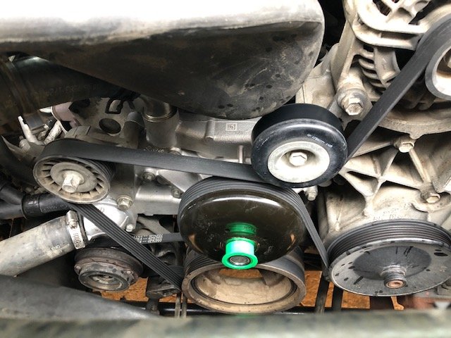

Thank you for that! I just did the install and it was sure nice only having to remove the Airaid. I used 11 ft. Lbs. on thermostat housing, 18 ft. Lbs. on pully, and 22 ft. Lbs final pass on pump bolts. These specs were from autozone web site. Hopefully those are the correct ones. The thermostat housing spec sounded a bit light so i went to 12. I really do not enjoy thread repairs so i didn’t want to go real tight. Filled with Dexcool and All seems okay. No more leaks and heater works again.

All set, OEM pump and thermostat. One of my spring clips was lost, used a regular hose clamp on upper rad hose until I can get a constant pressure. So much room without fan. I could have done it without even removing the intake. The local book labor rate for this job is obscene; glad I did it myself. I put in new heater hose Y too. i probably should have gotten a new pully in retrospect.
