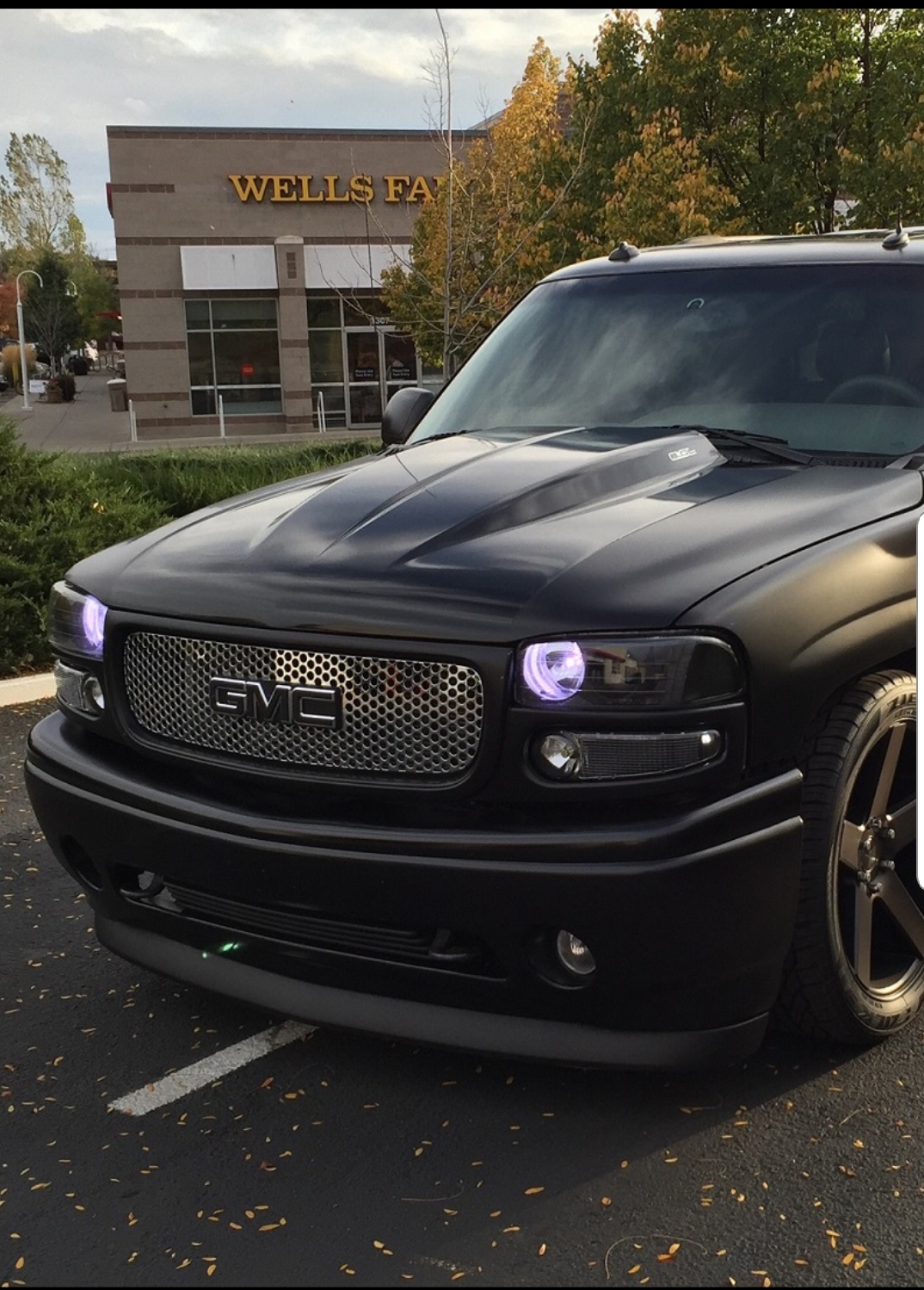

If it was on a GMT800 Denali it was an aftermarket piece that the owner added. They didn’t come with a lower air dam piece from the factory. There’s a few guys on here that have added them to their trucks. The first one that comes to mind is @Rocket Man , I believe he added one on his lowered 2002 Denali. Maybe he can shed some light on this subject?

This?

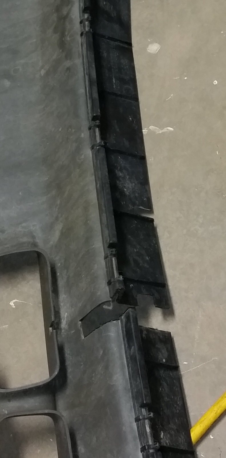

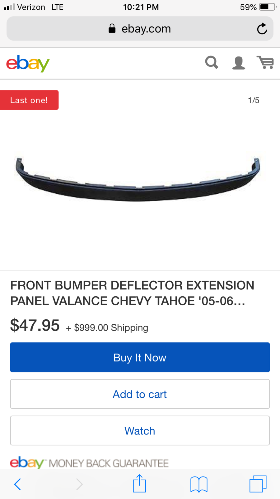

Same exact thing I posted, they are pretty much all the same. The part nimber I ordered for my 01 was -193
Neither will directly fit on your denali, you need adapt it to fit. I ended up drilling holes and used small black plastic ties. Like so
52,954
All the above info is correct, it’s the one for the 05 Tahoe. The ends are about 1/2” short of lining up with the fender but it’s close. It doesn’t follow the exact curves of the Denali bumper but you can’t really tell unless you look from underneath. I used screws to attach mine into the bumper lip. If you’re lowered you might drag it on curbs. I ended tearing mine up and have a new one but haven’t installed it until I get some more 26’s so it raises about an inch to clear.

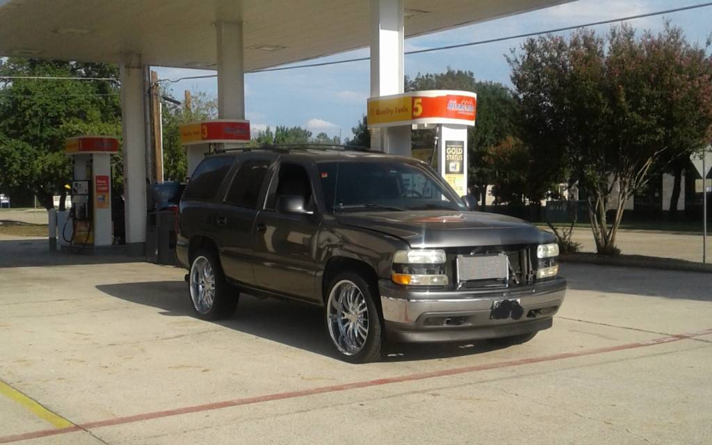

Get one while you can! Probably be a good snow plow if you up north and lowered lol. I have mine screwed in with some self tapping screws. It's not going anywhere.
