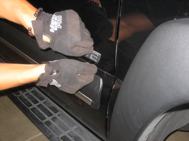

fishing line and goo gone works. the paints fine under the emblems and trim.

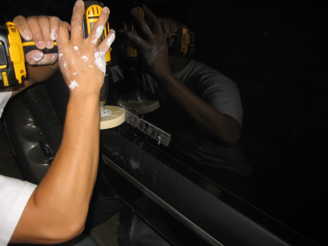

I use a plastic spackling tool. Make sure it's new or in very good shape as not to scratch the paint. Then a 3M adhesive eraser wheel will take the adhesive off effortlessly. After that just a good polish of the area and you're good.

This ^ the 3M wheel takes 5-10 mins, so much faster and easier than other methods.

x2 this thing works.
when i pulled my rear molding n emblems i used fising line, plastic sraper, goo gone, and wd40... it was a pain. when i pulled off the roof mouldings. i used the 3m wheel and my cordless drill. works awesome. and no sore fingers.

I'm going to have to use the 3M adhesion remover wheel for the last bit of adhesive where my decals were. My index fingers were rubbed raw after doing it manually.

And this is why you ALWAYS just use the wheel from the beginning :deal:

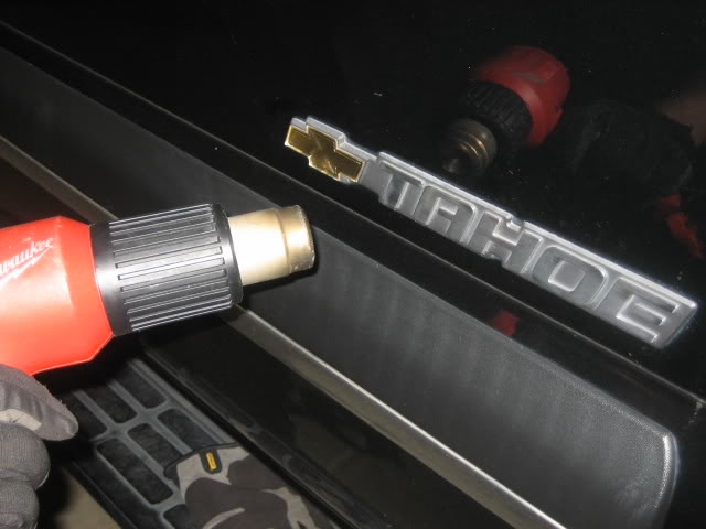

Step 1: heat gun
Step 2: fishing line
Step 3: 3M wheel
Don't waste your time with anything else. You'll be done in 1 hour

be care full not to burn thru the clear so dont leave it on to long.

Just want to thank for the tip to get the 3M wheel, it did the work in no time!

I highly recommend the 3M wheel, I spent about 15 minutes pr side doing it, once you get the feel for how much pressure to put on the wheel you'll be surprised how effective it is.
