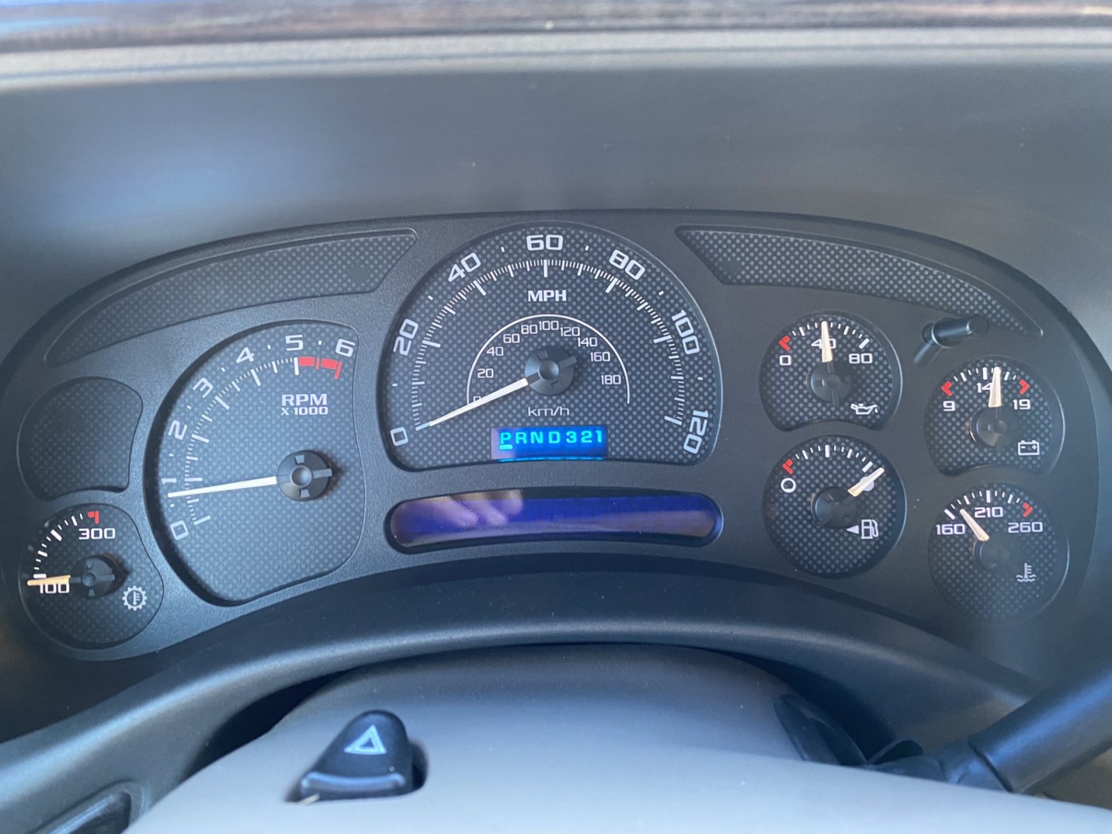

My attention has turned to the interior since, as I replaced some torn seat bottoms, updated my gauge cluster to the Esky style, and threw in a dashskin cover to start my two-tone theme (way too much TAN in these things). But now that its finally starting to cool down a bit here in FL I think I'm going to explore what my options are for leveling this monster to prep for a wheel/tire swap. Here's what she looks like as of now (I need to take more/better pics).
