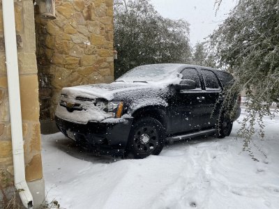

Today, I was able to get out in the sun and warmer-ish day to check if that door switch thing was coincidental. It seems to have been.
Turning the key I can hear a relay clicking at the under hood fuse panel. Does that mean the ignition switch is completely working? Not sure. I haven’t found a wiring diagram for the gmt900 starting circuits, so not sure where to probe for good signal.
