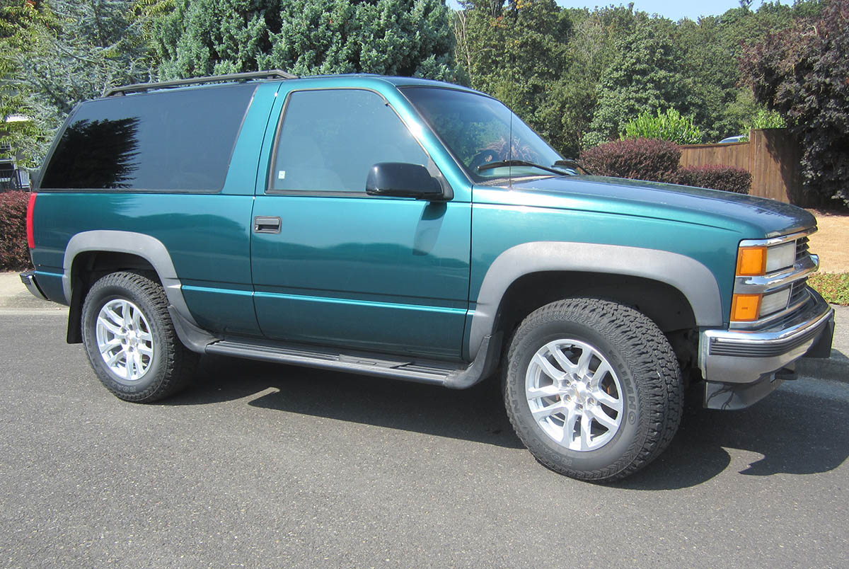

I bought new winter tires and had them put on a set of wheels I purchased a couple of years ago. I also had the brakes serviced. The fronts needed the rotors turned and new pads. The back were fine. That was a pleasant surprise.
Do you remember where you bought these Wheels from? I can't really make out the emblem in the middle, but I really like them, would love to know more about them.

I bought the wheels off of Craigslist. They are Silverado wheels off of a 2019 or 2018 (I can't remember which). I got the set for $250.
I've been doing a bit more. I changed out the headlights and driving lights. The headlights don't look as good in the picture, but I'd give overall fit and finish a B+ for them. They are Depo lights and I've never had a problem with this company in the past. The driving lights, OTH, were a pain. They look OK, but they aren't contoured like the factory housing was. Every turn of the screw made me think I was going to break something.
