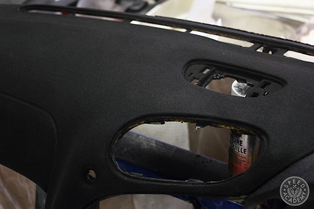

Have any of you guys heard of dash flocking? If I was going to do anything to remedy cracks and glare, I think it would be something like this.

That looks good. Hey if its good enough for Rally drivers, its good enough for me, hah.
I just dread the task of removing the dash itself. Not going to be a fun project.

looks like it would be impossible to keep clean dust would just settle in and stay
yeah.. and it looks like you have to fix the crack to begin with .. plus.. I don't see how it would prevent cracks and therefor even prevent them.
