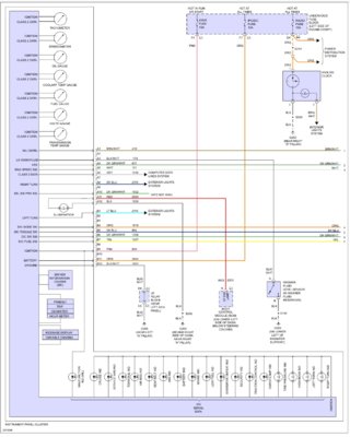

You can see the cluster illumination is A11 and A12 in the harness. Check with a multimeter.

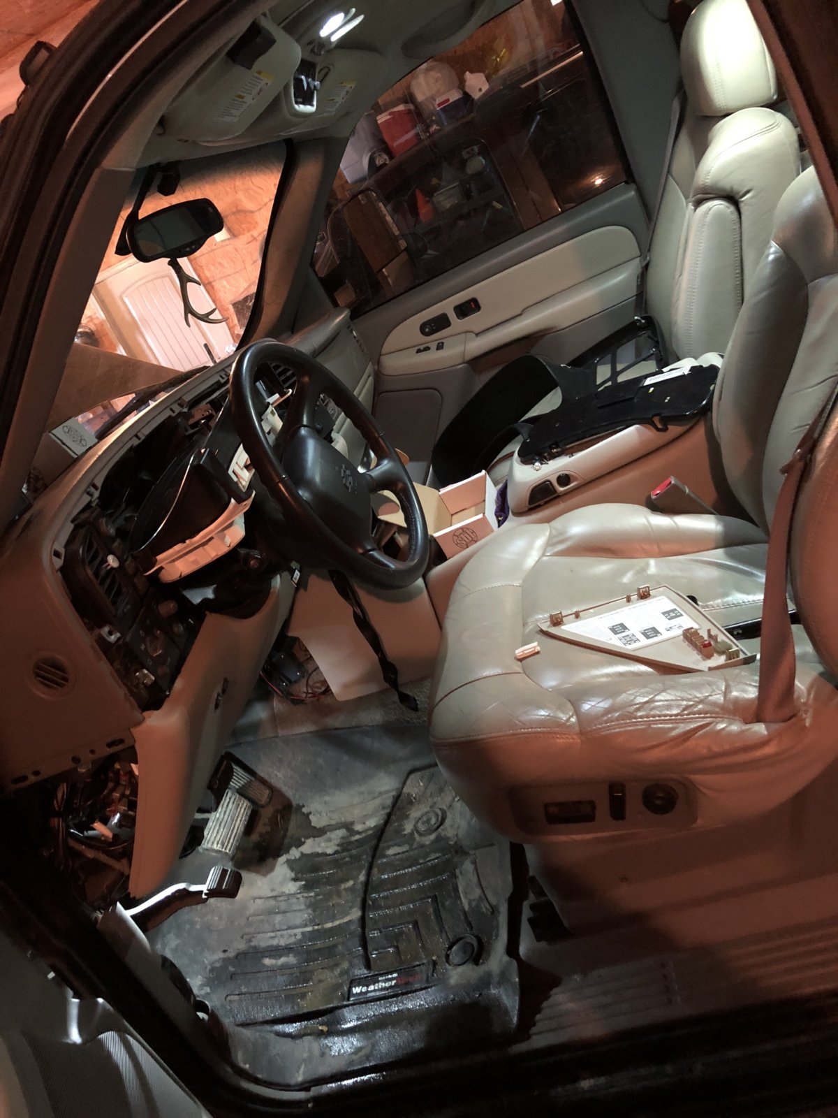

I feel like such an idiot for going into such a frenzy trying to figure it out all when I had to do was turn up the dimmer. I must’ve bumped it and turned it down. :mfr_omg:
