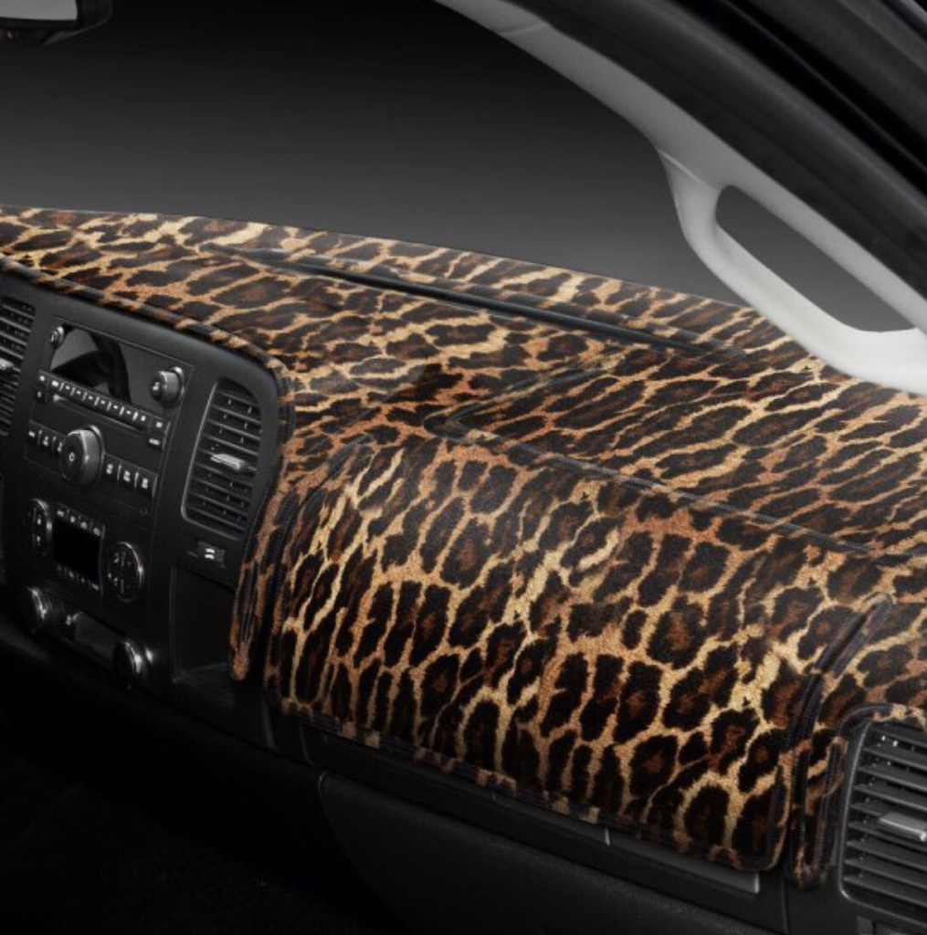

Just get one of them dash pads or covers for ~$50 and call it a day

Maybe, but it's an option for someone who doesn't want to spend the coin on a new dash

The dash skins for about $100 to $150 look good for not much more though. For $50 you get the carpet covers that look horrible imo. But yes there are plenty of options.

In regard to the dash fix, our long term plan is to obtain a donor dash from a wrecker. From there we’ll shop for a suitable wrap that’s tolerant of UV and have it recovered. There’s no need to get that deep into an oem repair when GM’s dash formula doesn’t have adequate UV protection.
We figure 1 - $1.5k to do the job depending on the materials. Once it’s complete, the value goes up higher than an oem refurb because it’s fixed oem plus, forever, in good taste. Sorry no faux animal prints here.

Although Dash cracks are ugly, that animal print dash cover is totally disgusting LOL. I am going to glue this one with permatex plastic weld and see how it does.......I do not have enough beer to get through the Mother Of All Dash crack Thread just yet Haha
