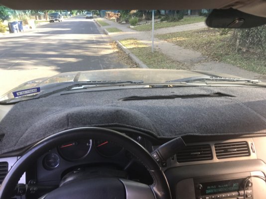

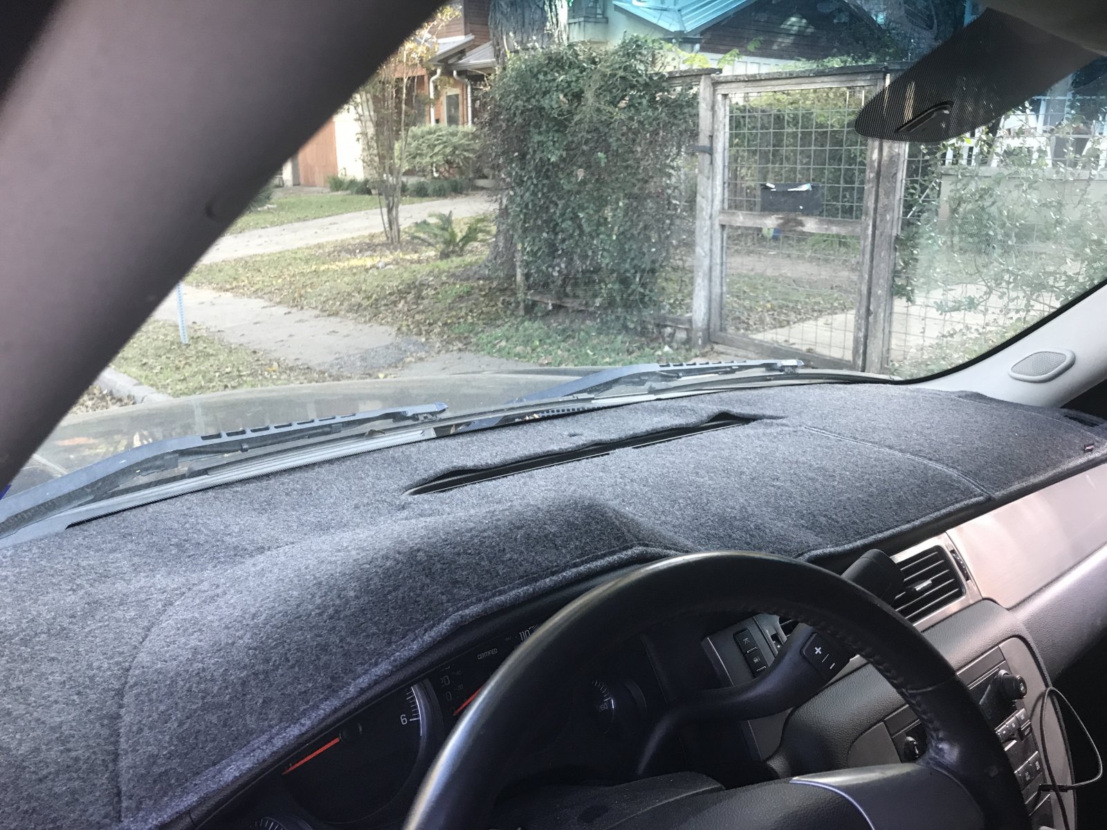

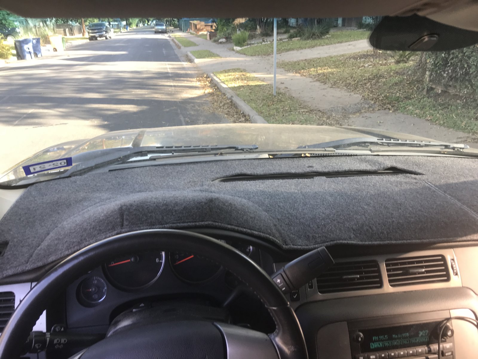

Hey Ron, the dash on my 2011 DPS Tahoe was so full of cracks a repair like the video shows was a no go. After researching dash covers I decided that was more money and time than I wanted to spend, especially with the varying reviews of that method. So I went with a very easy and relatively inexpensive dash mat. There are a couple of options but it is basically a carpet for the dash. I just covered the whole thing up. It looks nice and was cost effective and fast. Here is a pic. Good Luck
