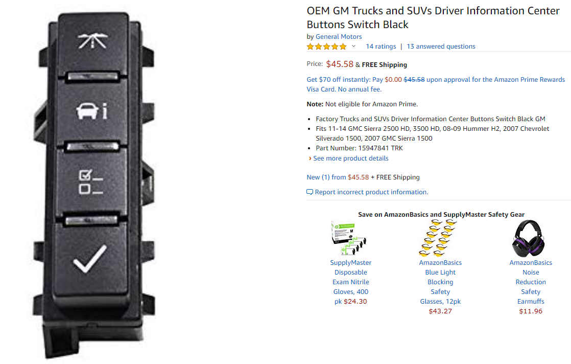

I'm guessing you need a new switch assembly. They are around $50.

The switch assembly just unplugs and there are tabs that hold it in place; release the tabs and the assembly pops out. Easy.

Ok thanks. That’s good to know. Is it just the one piece of trim around the buttons that needs to come out? I always feel like I’m going to snap the trim in half when removing it...
52,949
It’s the whole piece that goes across the dash. It’s not bad to remove. Start at one end and work your way across. It helps to have a plastic trim removal tool. Something like this set from Amazon.
