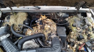

What’s up folks!!?? I have a p0302 code, stabilitrak and flashing engine light on my 2011 Tahoe. Checked the #2 coil, no sparks, bought a coil and planned to replace it. Opened the engine cover and the wires were chewed right through. Now my dilemma is do I change the wire harness for all the coils on that side ( their sold as one piece with 4 wires) or just the one wire/coil . Any info would be great!! Also, how the hell do you get to the wire harness??!! I included a pic....

No pic opens up and I would do all on one side.

I would try fixing that one by itself.

Had the same issue with squirrels. Replacing the wiring just for the single injector worked fine for me, that was two years ago and it still runs great. I simply spliced in new wires.
As to the squirrel issue, I bought some pepper spray varmint deterrent at home Depot and gave all of the exposed wires a good dose. No more squirrel problem - just remember to wear gloves when working on the engine from now on.

why wouldn't you fix the wire? get shrink wrap tubing, your soldering iron and patch that section of wire.

Yes, varmints eating wiring is in part due to the transition away from oil-based wire insulation to plant-based wire insulation (soy beans). The plant-based wire insulation actually attracts the varmints to chew them up. One of the down-side trade-offs on going 'green'.
I've put rat poison in my portable garage, where I house my truck, as I've had both mice and squirrels 'visit' it in the past month.
I'd go with the recommendation to try to fix those particular wires first, before considering replacing the entire wire harness.
