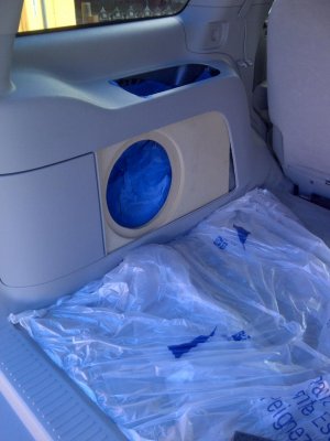

I'm in the process of getting a custom box built in my back wheel well. The box will be fiber glass and have a custom cover.
I have a 10" Kicker Solo Classic that I had in a small box behind the 3rd row but I wanted a more factory look. Below is a pic in the early stages but it should be done tomorrow. I will post completed pic tomorrow.

Interesting...
I think it has potential to look good!. What year is your truck and do you have the automatic lift gate?
more pics of behind the plastic and the entire box please....

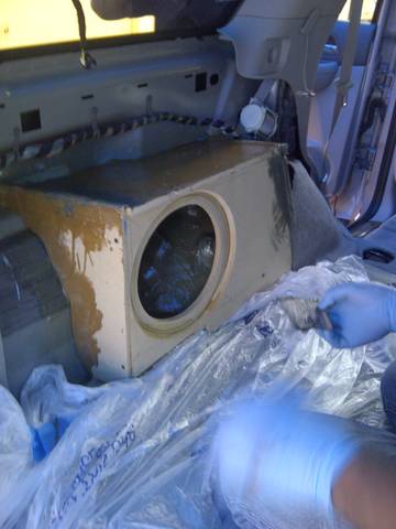

I'm having it done because I don't know enough to do it corectly. The box will be permenent. He cut out the big plastic piece and attached the front piece you see. He then built a side piece that fits inside the well and the rest will be fiber glass. The blue you see in the well is tape and he will fiber glass over that. The box will basicly be built inside the well. He will use some type of fiber carpet to construct the other side and top and then fiber glass it all while its in the wheel well.
The front will be covered in matching grey vinyl and have a bowtie logo in it.
I have an 07 LT and it does not have a auto liftgate. The only thing that needs to be removed is the jack. I was also able to keep the storage area which I like.

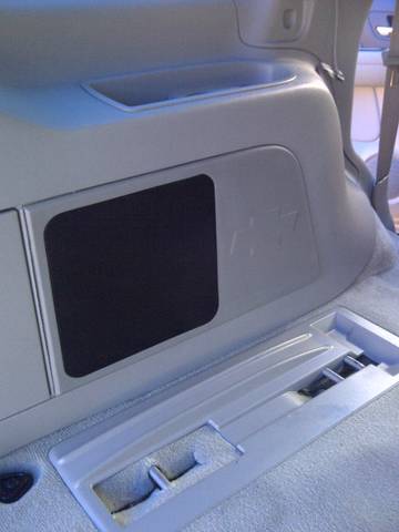

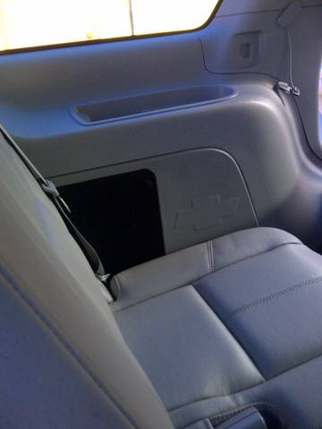

Well it's done and I have to say, it looks great! One of the best things I have done!

It sounds good, not as good as a standard box but its really close. They had to try it twice because the first time they did not use enough fiber glass and there were leaks in the box, so it sounded bad.
They fixed it and added more fiber glass and enclosed the box much better and it sounds almost like my old box. This is much better beacuse of the factory look and I have full trunk space in the back. I also don't look like I'm in highschool with a big sub box in the back of my truck.
