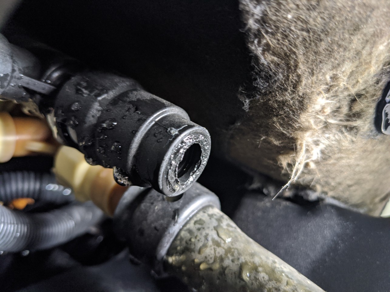

Definitely change out the Tees and heater hoses, or as @Doubeleive stated they will rupture when you least expect or want them to. Also, when you change out the tees, be sure to wear gloves, as the firewall insulation is quite aggressive, and your hands will itch for days.
