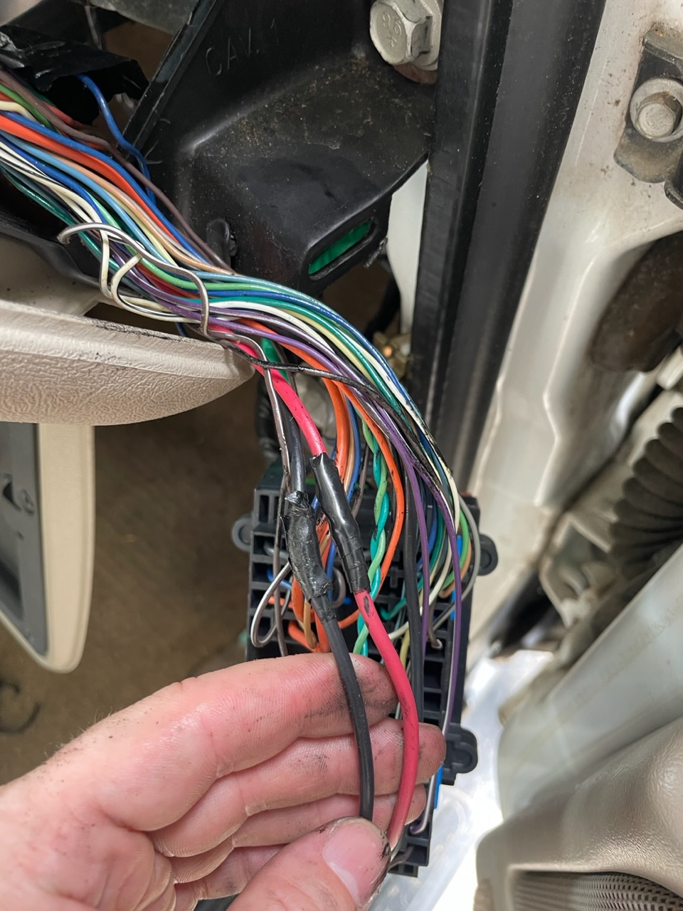

I found the source of the current draw. After unplugging everything related to the blower controls and still having the draw, I started following wires under the dash. I found a random power and ground spliced into the factory harness. Followed that up to a gps unit zip tied to the harness with all its other wires cut. Once I cut the wires the draw went away on my meter. I guess at some point it failed and started drawing power?
View attachment 404497View attachment 404498
Car was probably financed at a buy here/pay here lot once.
