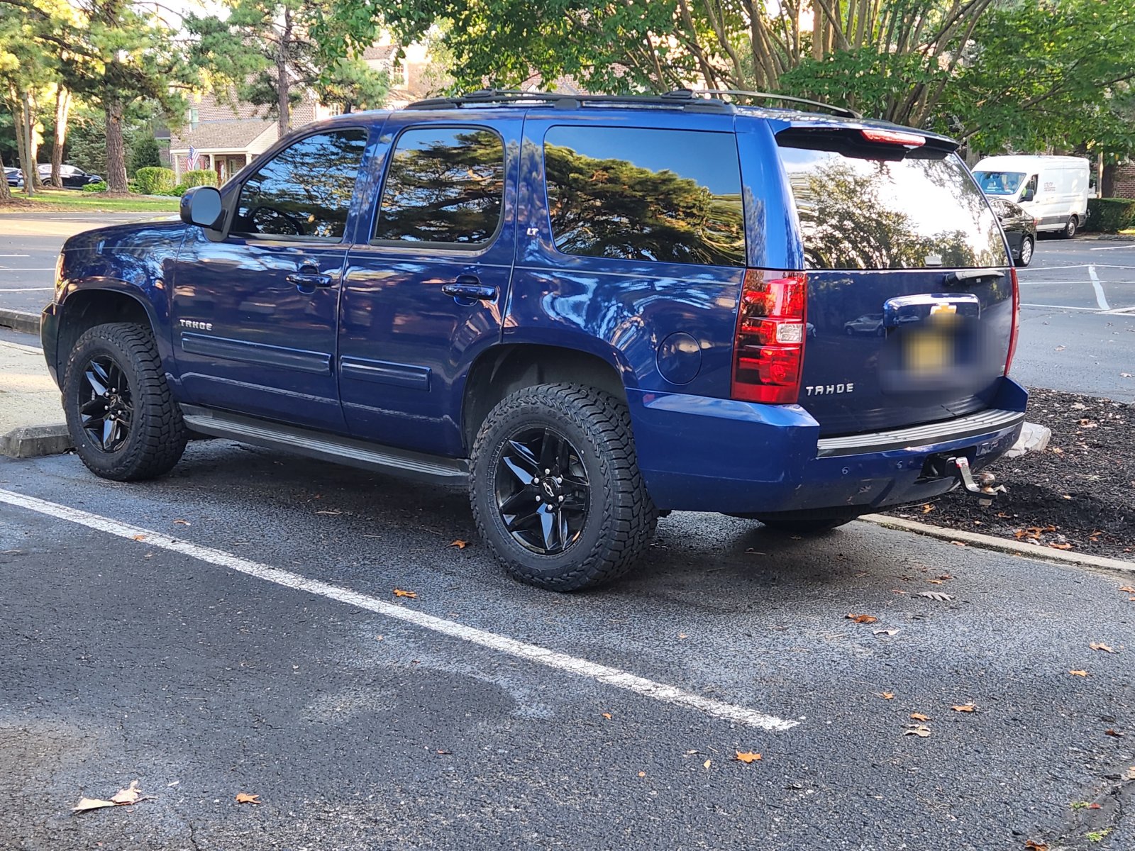

I put the 18s from a newer trailboss on mine fits fine offset is lower so they sit flush.
