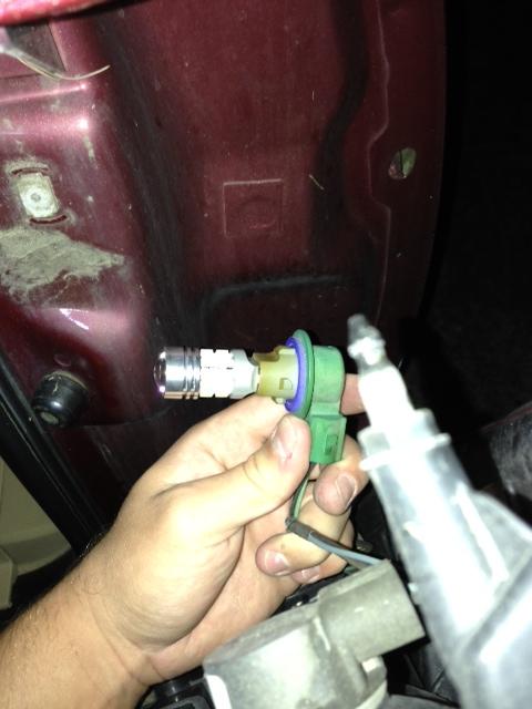

Install was really simple.
Just took the lamps off, pulled the socket, removed the 7440 bulbs, and stuck the LEDs in.

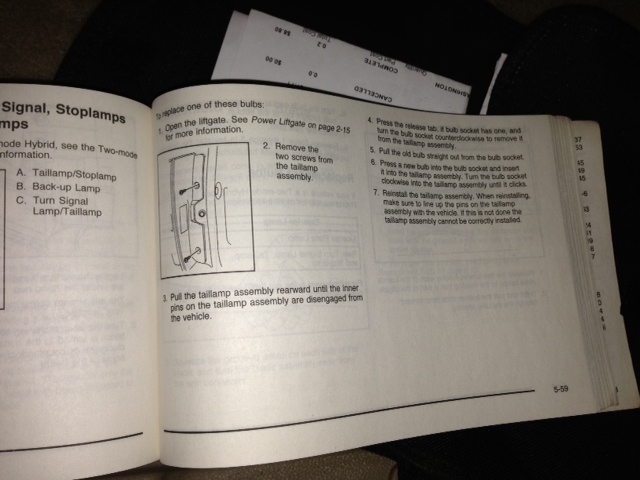

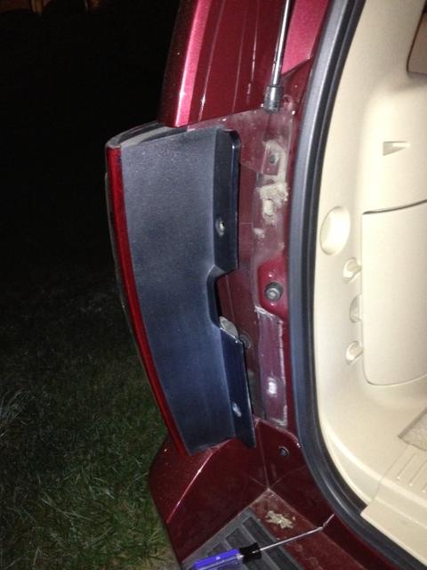

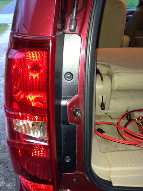

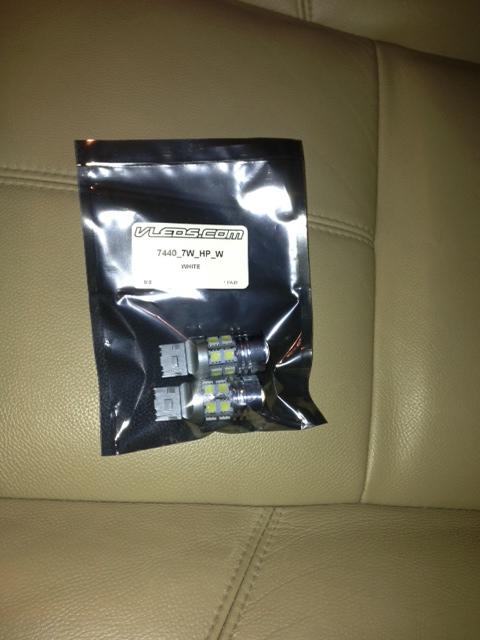

Got the lights in today! Pretty good shipping from VLED's--I ordered them Sunday afternoon and got them in the mail on a Wednesday. Install was super easy, as most people are saying. It's actually detailed in the manual on page 5-59:
Install takes literally 5 minutes. The only reason I took any more time than that was because I was stopping to take pictures for you guys.

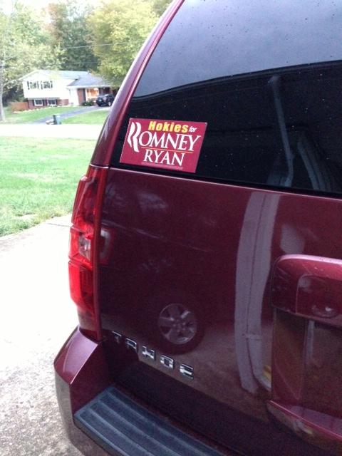

So first we open the tailgate (yes, I'm basically just posting this pic for the sticker):
And can easily see both screws (Phillips head, btw):

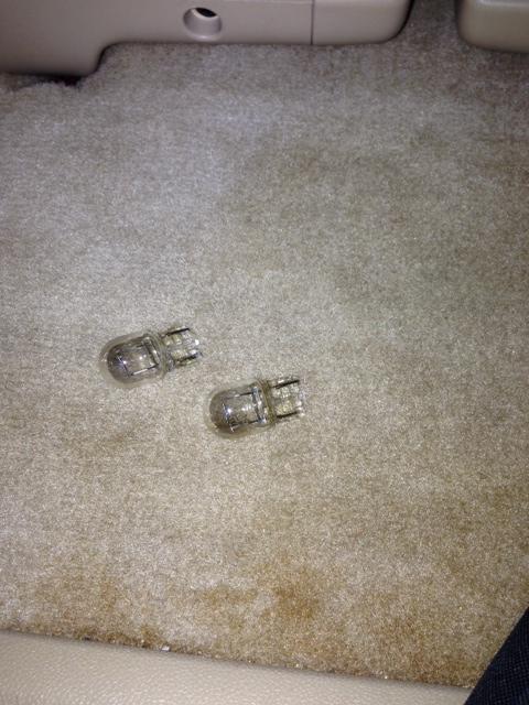

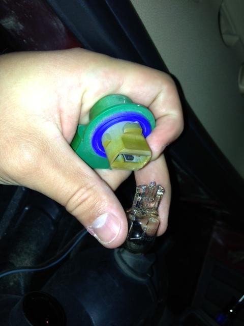

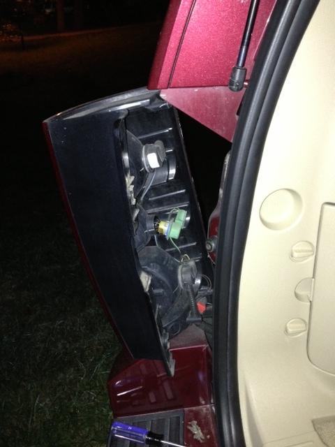

The first picture includes the instructions so from here on out I'll just post the rest of the pictures without explaining each step:

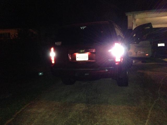

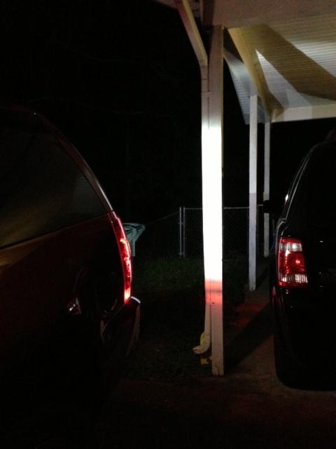

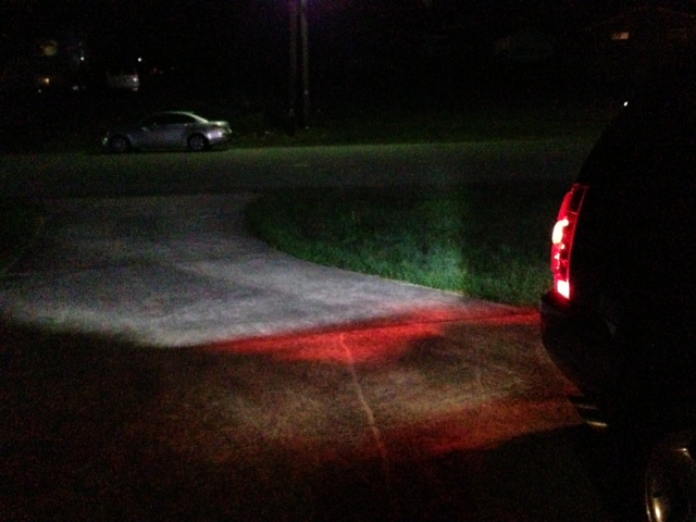

And now, the part you've all been waiting for--Before:

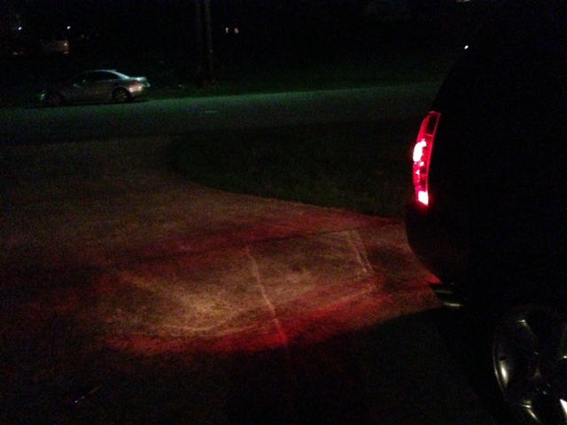

...And after:
Notice how much brighter the cars across the street are. In the second picture you can even see a van in the driveway.
I have NO idea what's reflecting in the grass in this picture, and now I'm really curious.
So far I haven't had a chance to really experience them except turning the truck around and reparking it in the driveway, but you can tell from the pictures how much brighter these lights are. VLEDs had them for $40 and I was able to find a discount code online which saved me like two bucks. Whatever, I'll take it.

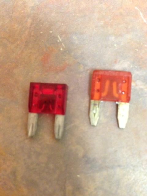

Okay, must be a fuse. I managed to pick up some fuses when I stopped by a Wal Mart but it cost me 4 bucks for two of them. Again, I'm adding to the original $40 I paid, but whatever. I changed the fuse and thought I was done, but later realized they again were not coming on. ************, are these lights blowing a fuse every time?
So an hour ago, I try again. To rule out the possibility that I got the wrong fuses (#10, red), I decide to take one out of the spot that's listed as "trailer reverse lights" and put it in the reverse lights slot. Blown immediately. I ended up removing the Crees and reinstalling the original reverse lights for a second time. After I do that, I put the remaining new fuse in the reverse light slot and they work fine.
I tried to find the lights on V-LEDS' website but it says they're sold out. I'm guessing that maybe they sent me lights with a different wattage or something. So far I've spent $40 on the lights and an additional $19 trying to make them work and I'm not looking forward to paying more to send them back a second time. If possible I'm going to see if V-LEDS will just refund my money and I'll find working Crees somewhere else.
