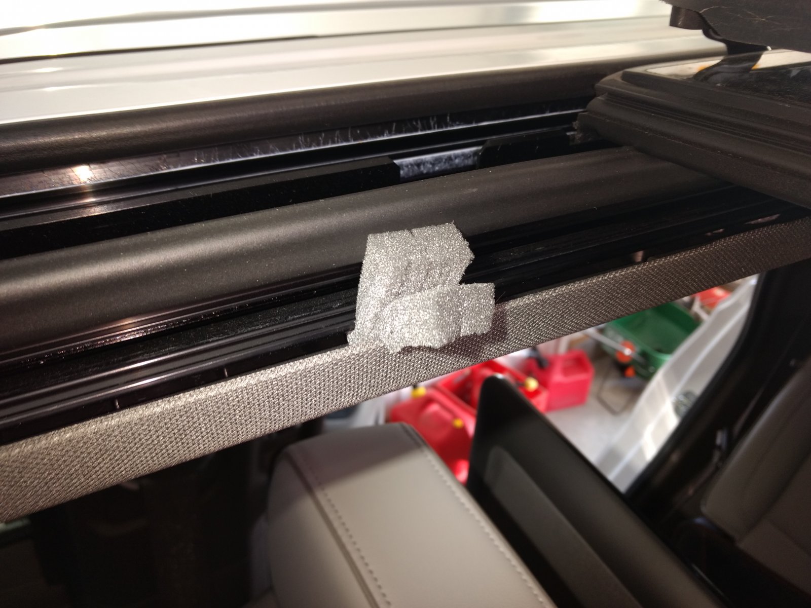

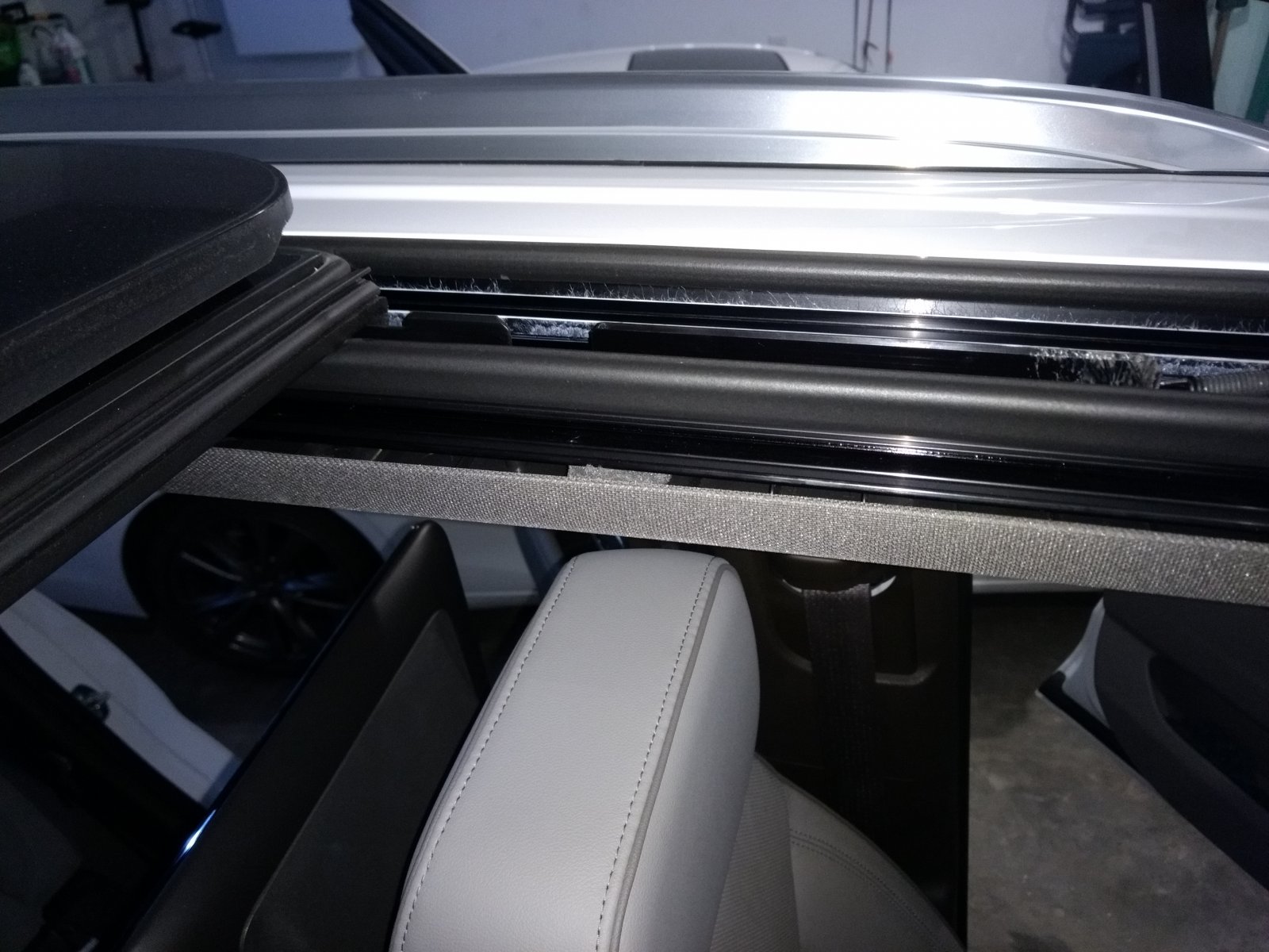

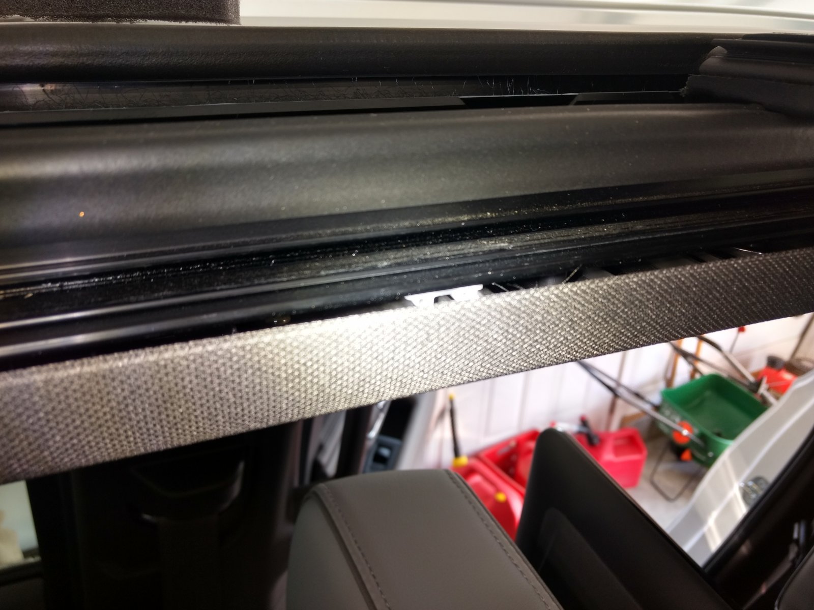

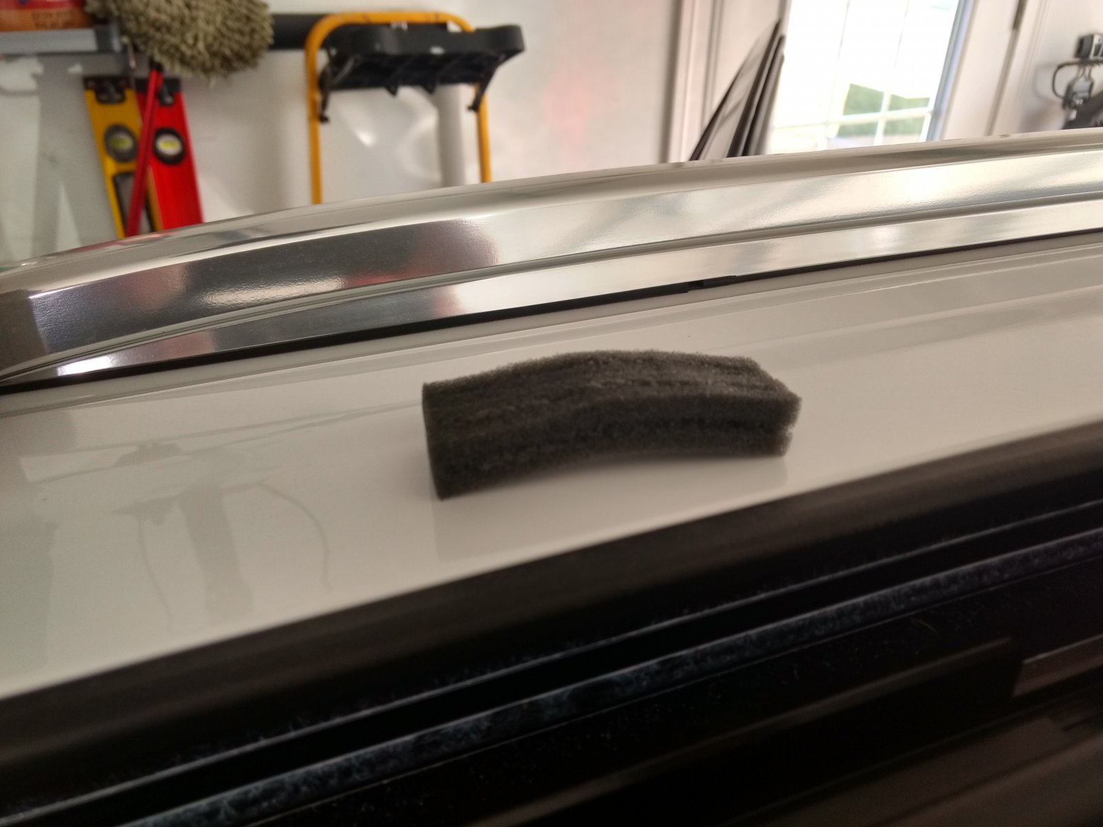

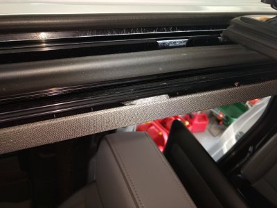

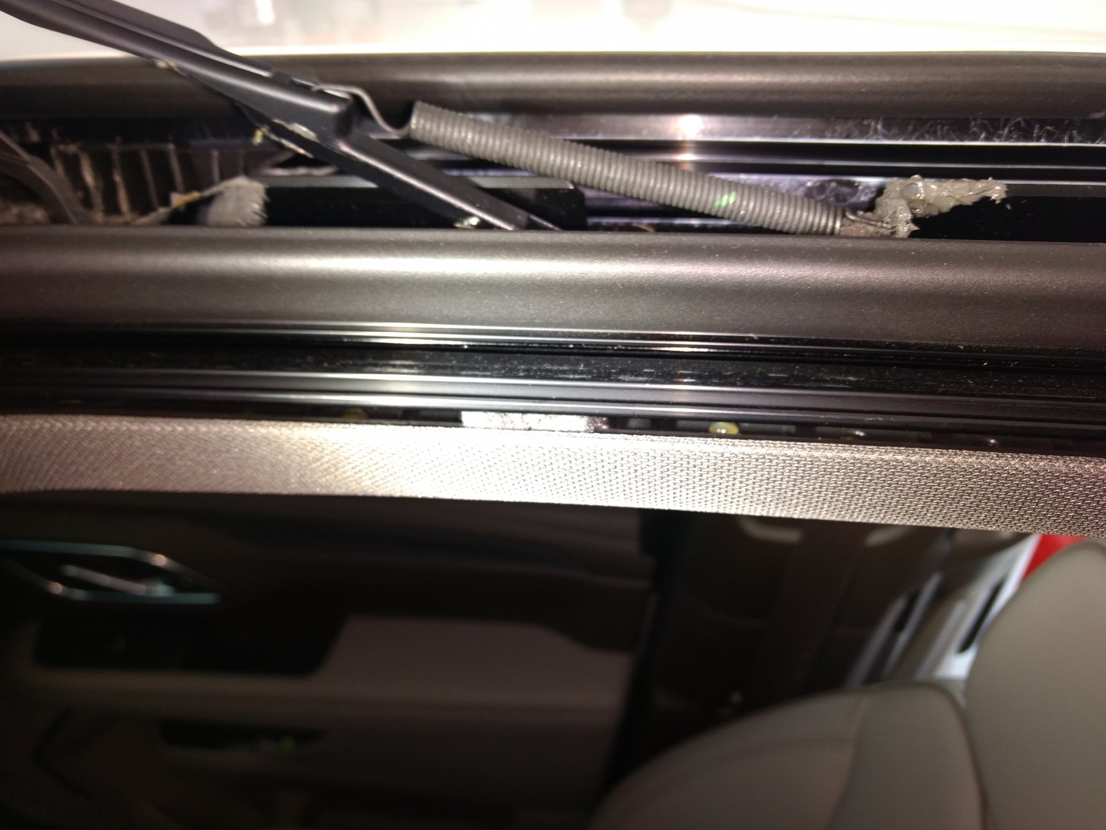

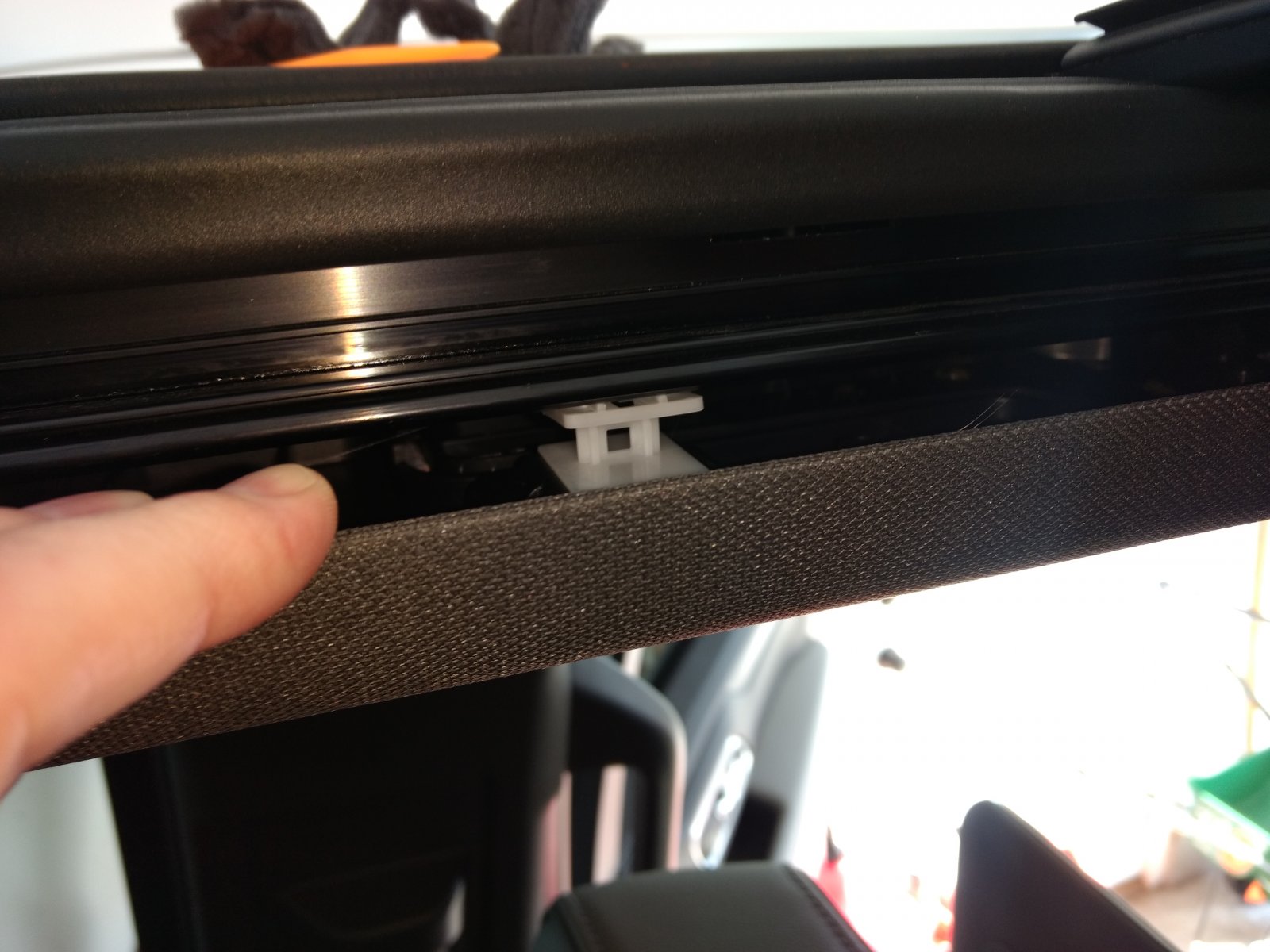

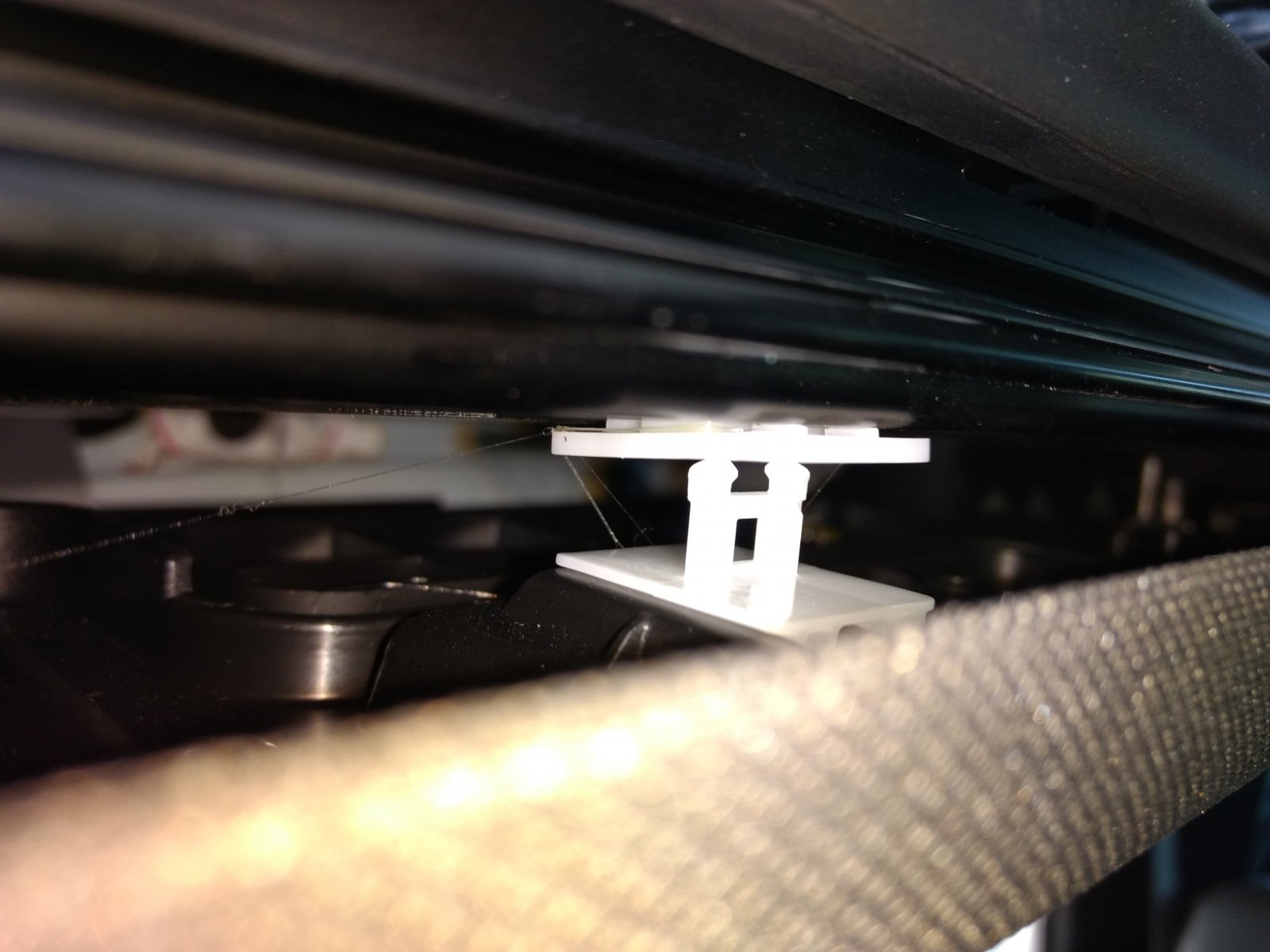

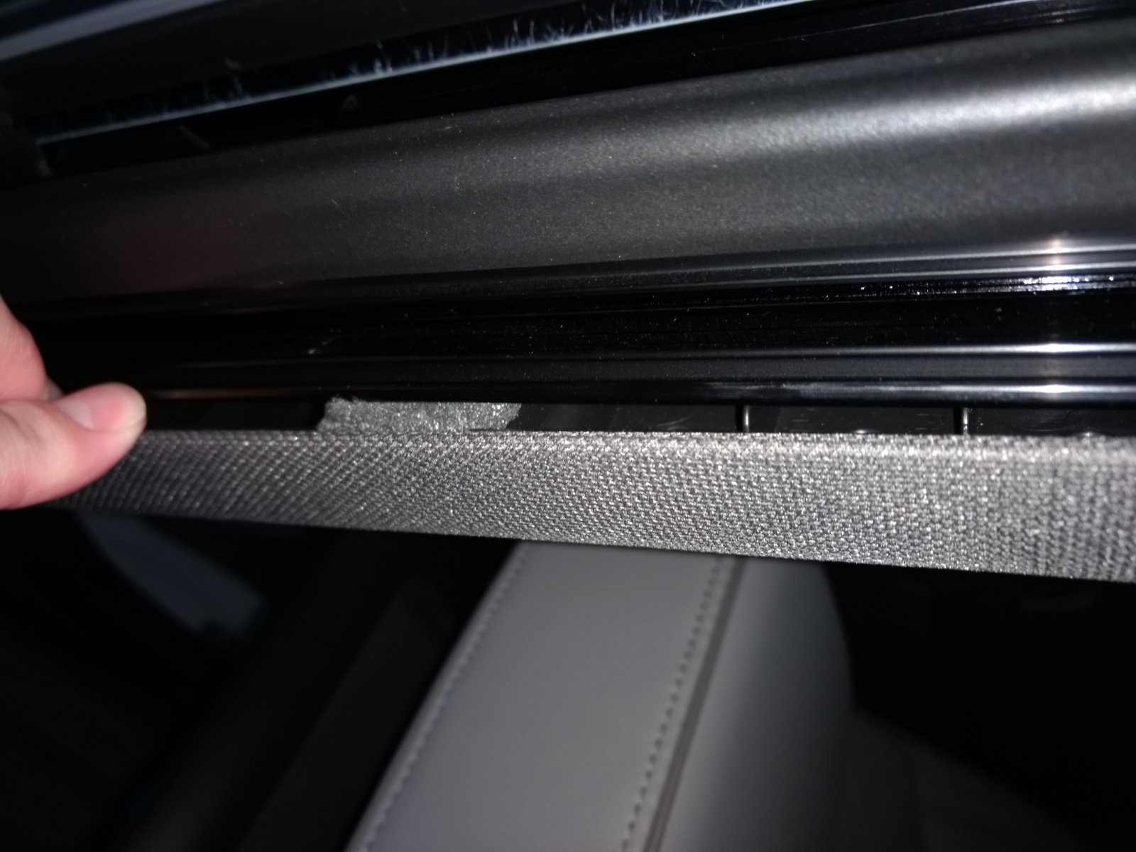

Pics of foam size and location for my passenger side. I used just two strips of Pelican case pluck and pull foam strips for each.
View attachment 260270 View attachment 260271 View attachment 260272 View attachment 260273 View attachment 260274
Are you using two strips so it can be thicker? In the bottom pick of the foam is that one strip or 2 on top of each other? And it looks like you are pushing in so it is perpendicular lengthwise vs running long ways along the rectangle of the sun roof.

Yep, I'm using two strips. The bottom pic shows them together. Its just enough to fit really snug up against those white clips. I tried to show the clips, and before/after of shoving in the foam. I don't think position really matters as much as the amount. Just as long as its snug to prevent movement of headliner.
Everything feels tight now and I don't get that creaking sound by gently pushed up on headliner. We could always add more at different locations, but to me it seems the sounds generate from the connector location.

Yesterday I did some more testing and found some interesting results. The white clips are two pieces. The top part of the clip actually is installed in a track around the pano and is the female part of the clip. You can slide it back and fourth along the track the entire length of the pano. The bottom part of the clip is the male end and snaps into the headliner trim in certain places. There are 4 clips on each side of the pano. The clips are extremely fragile and break very easily. The part of the clip that breaks is actually up in the pan frame track. You will notice a clip is broken when the top part of the clip will no longer stay in the upper pano frame. While trying to reposition my foam I broke 2 of the 4 clips. I popped out the middle two clips that were broken and used some foam (1/4" thick) on each side of where they "would be". This morning there was no noise on my 30 mi commute to work. It seems like the more you reposition your foam, the more the noises move around. Again, it seems like the white clips and how they fasten in the pano frame are the culprit. My next test will be removing all 4 clips on either side and see how that works. They don't seem to really be doing too much. I might even consider adding some velcro.

It is 100% the clips. On the way home heard the noise again. Removed the 3 clips twards the front on both sides. Zero noise.

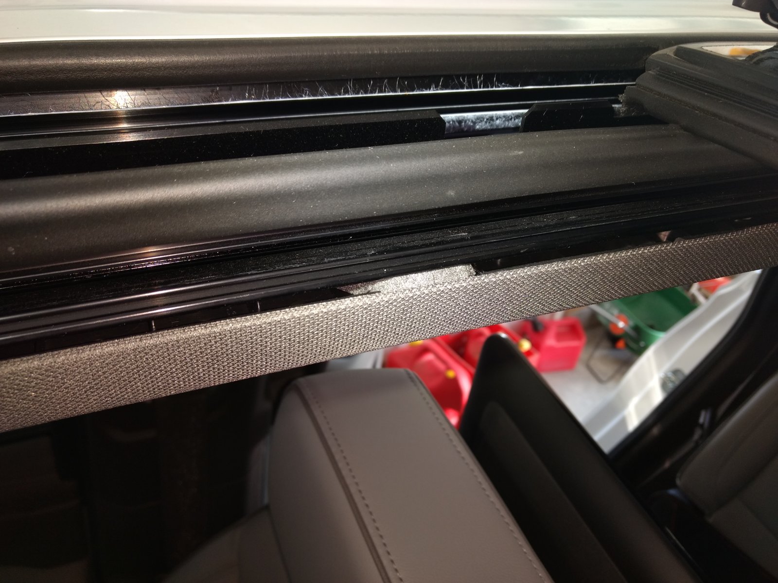

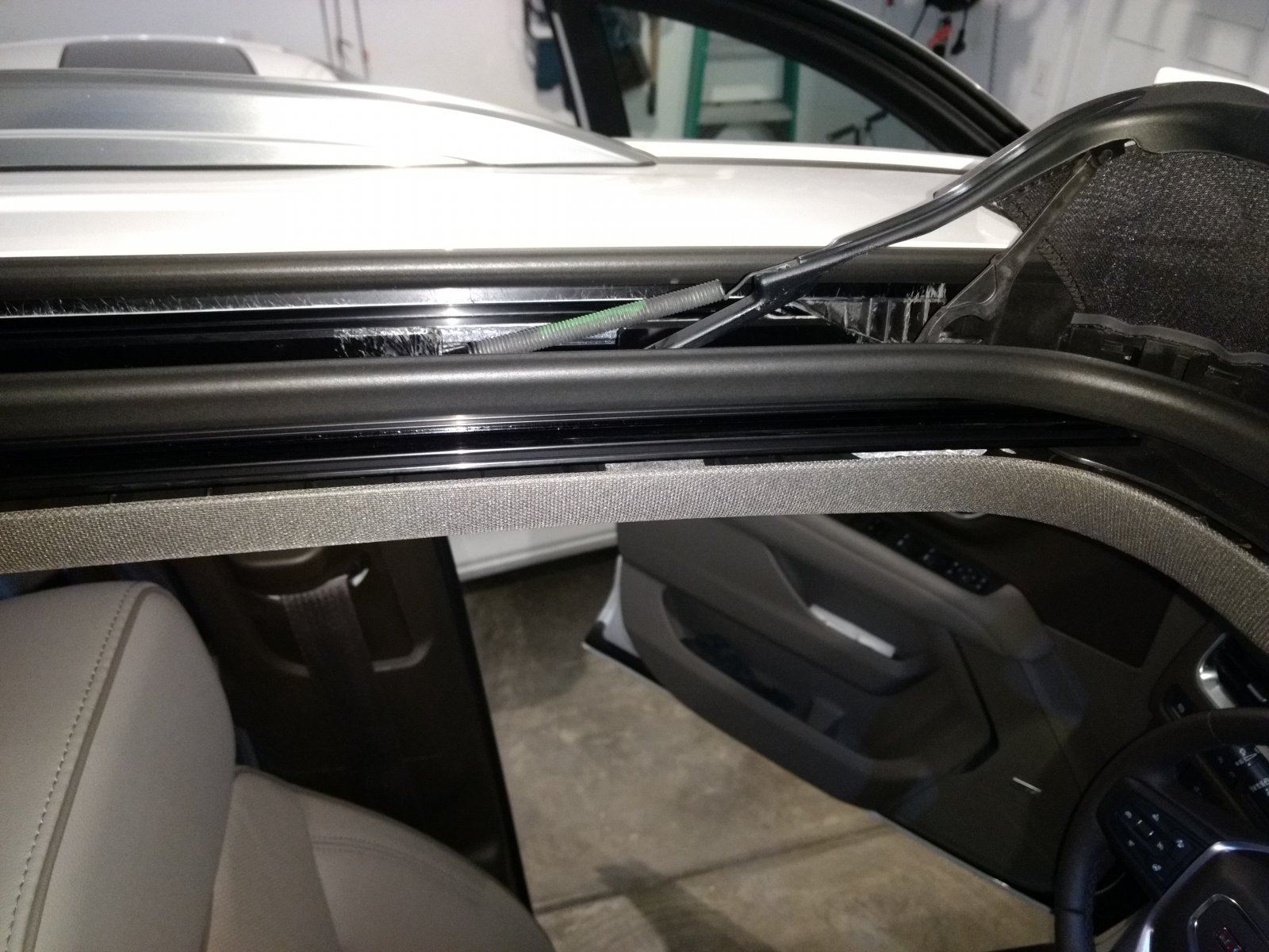

What if we put felt tape in between the male and female clips? I can't tell if the noise generates from friction between the clips or from the female(top) clip and aluminum pano frame? Or both.
