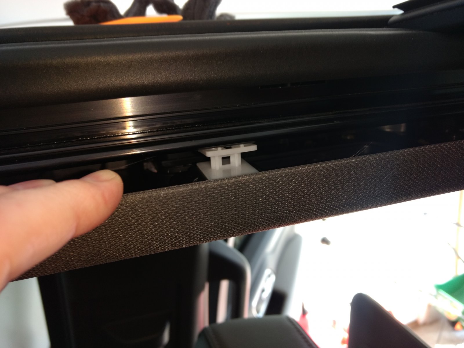

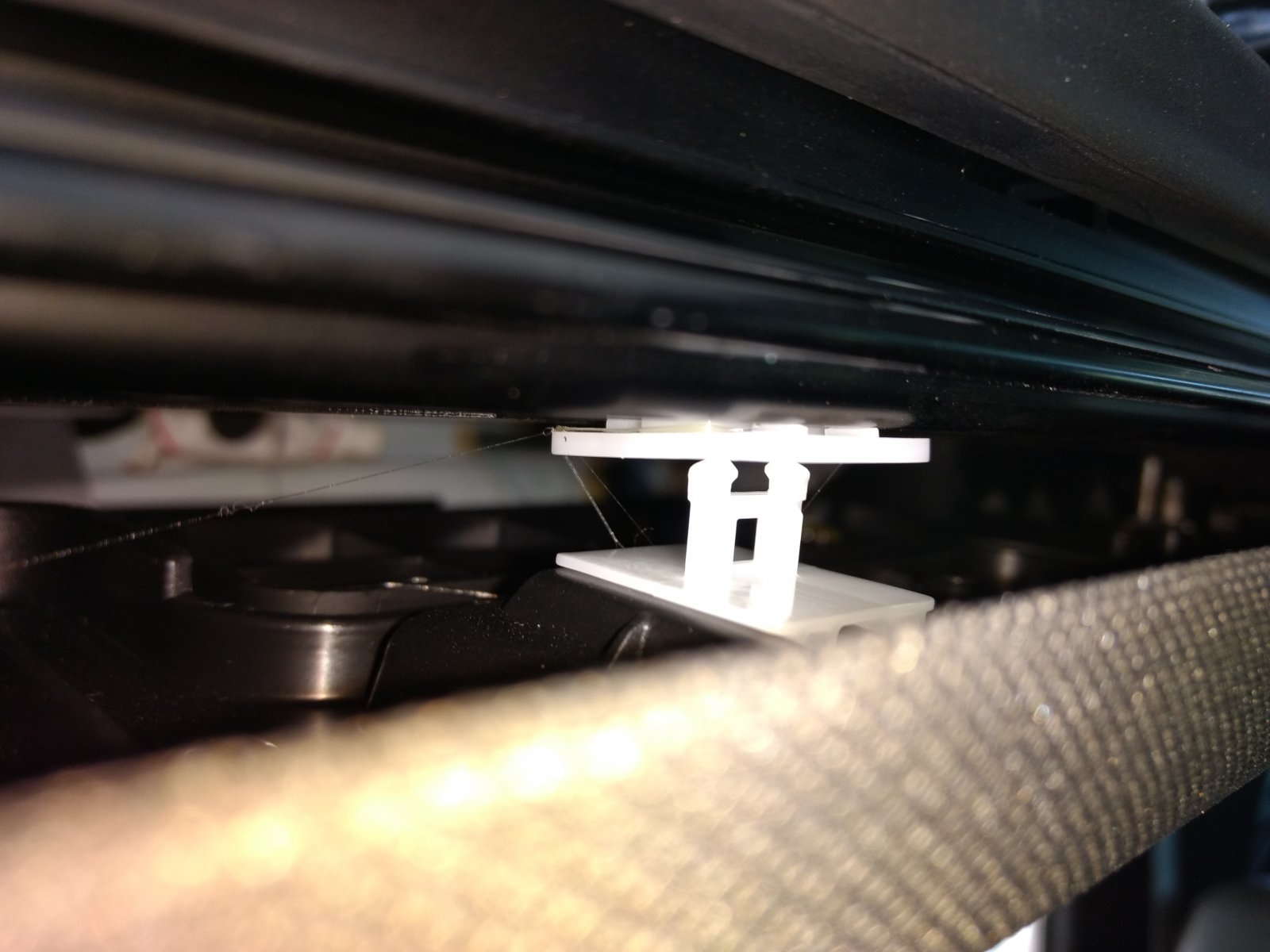

What if we put felt tape in between the male and female clips? I can't tell if the noise generates from friction between the clips or from the female(top) clip and aluminum pano frame? Or both.
View attachment 261890 View attachment 261891

I removed all of the foam this weekend, so service can get a good listen for this Wednesday. While removing the foam, the connectors started to disconnect, which allowed me to get a much better look inside (photos in Nov 7th post). I thought about cutting the two posts off the male end connector and using adhesive Velcro in between. May try the silicone route if service dept can't fix, which I highly doubt. Then again, once I get silicone up there it may be difficult to stick Velcro afterwards, if needed.

I have this creaking too above the passenger rear bucket. Going to try some foam... after looking in there, it is certainly tight. For those that removed the clips, were you able to do that without breaking? Perhaps not that important if they aren’t doing much — is the role of the clips to hold the headliner in place? It does seem to be coming from the clips. Thanks for the pics, that was definitely helpful!

It is 100% the clips. On the way home heard the noise again. Removed the 3 clips twards the front on both sides. Zero noise.

No issues at all. No foam or fillers, just removed all the clips on both sides.
