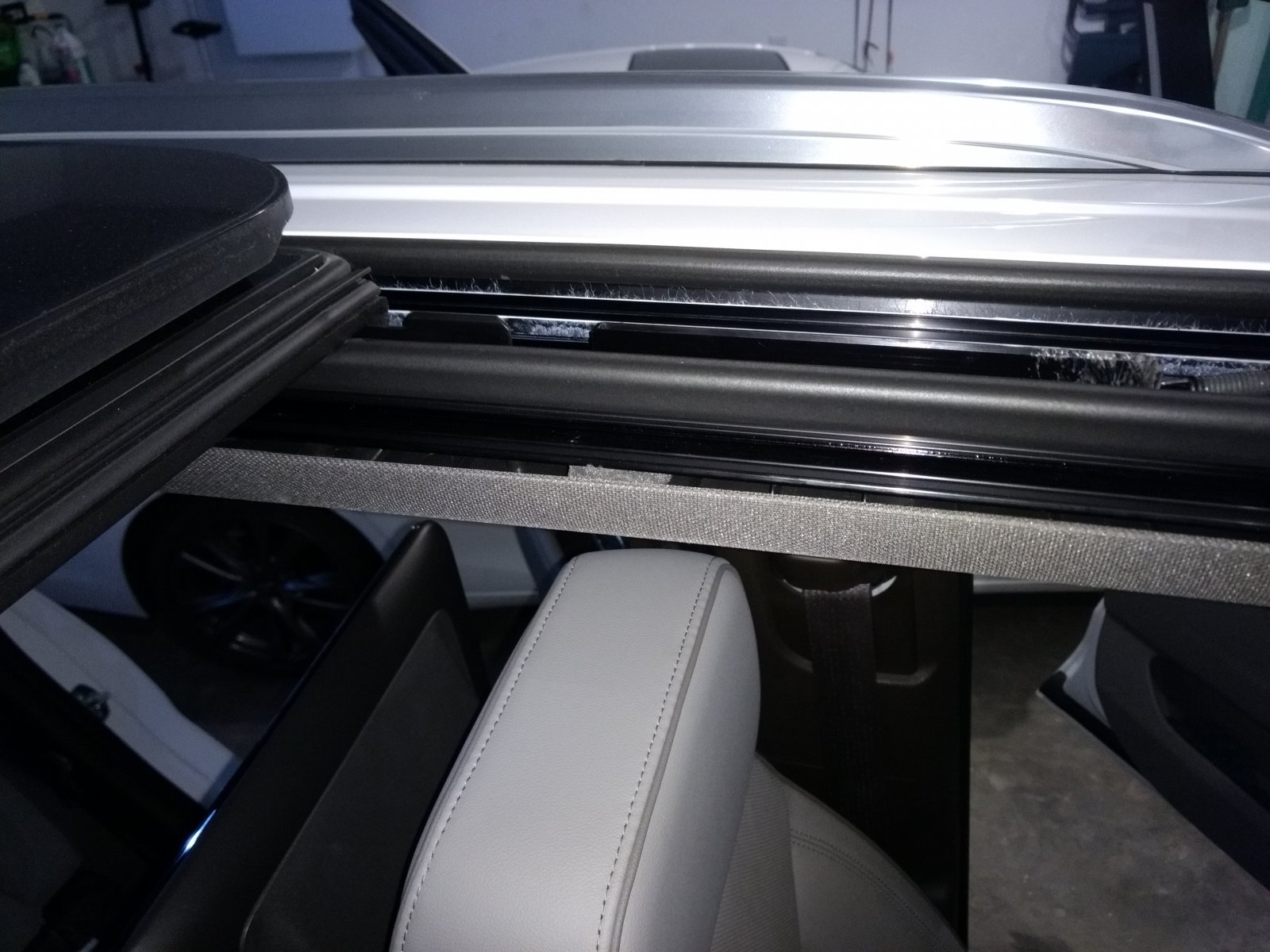

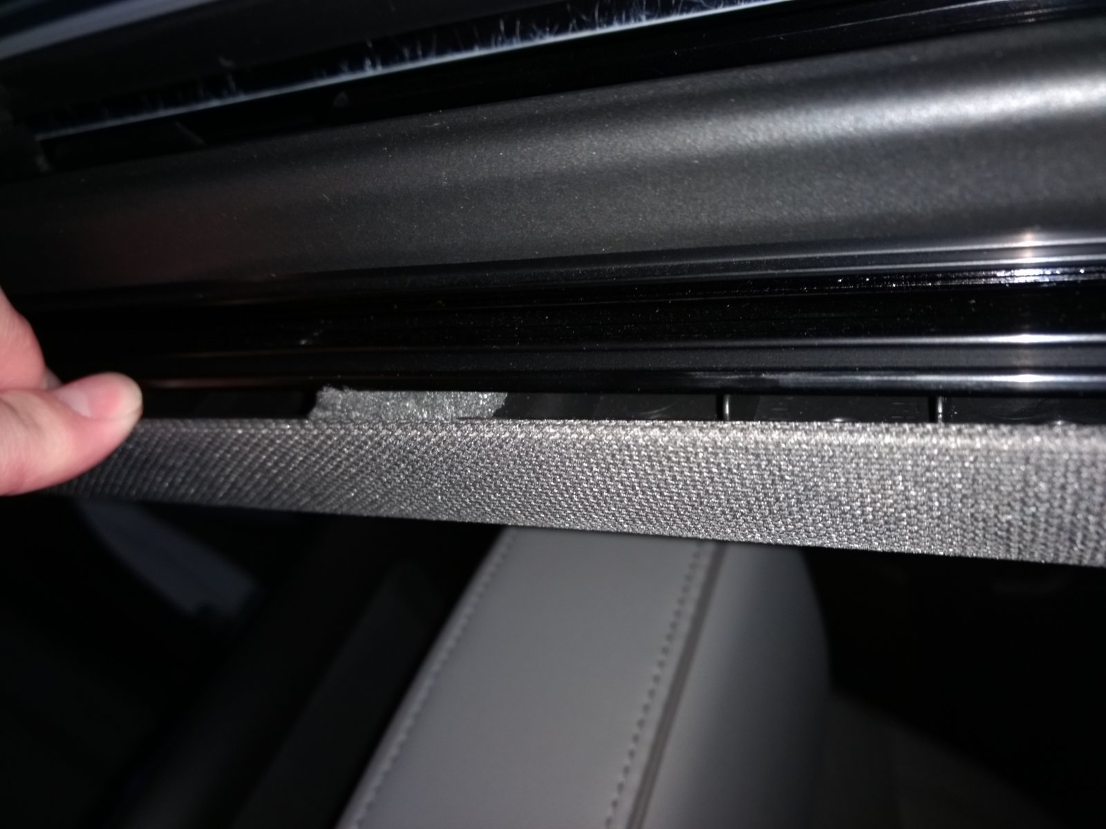

I have the same annoying sounds since day 1! I've found that adding foam (Pelican case foam) in between the headliner and the pano roof frame helps considerably. I shoved the foam pieces right where those plastic connectors are located. To me, it seems the plastic creak right where they touch the alluminum frame. (plastic to metal).
It truly pisses me off that I must find work around for annoying problems and now I have the water sloshing sound to troubleshoot. Dealer could not fix the creaking sounds, so foam it is!

Could you post a picture so we can see where/how you inserted the foam?

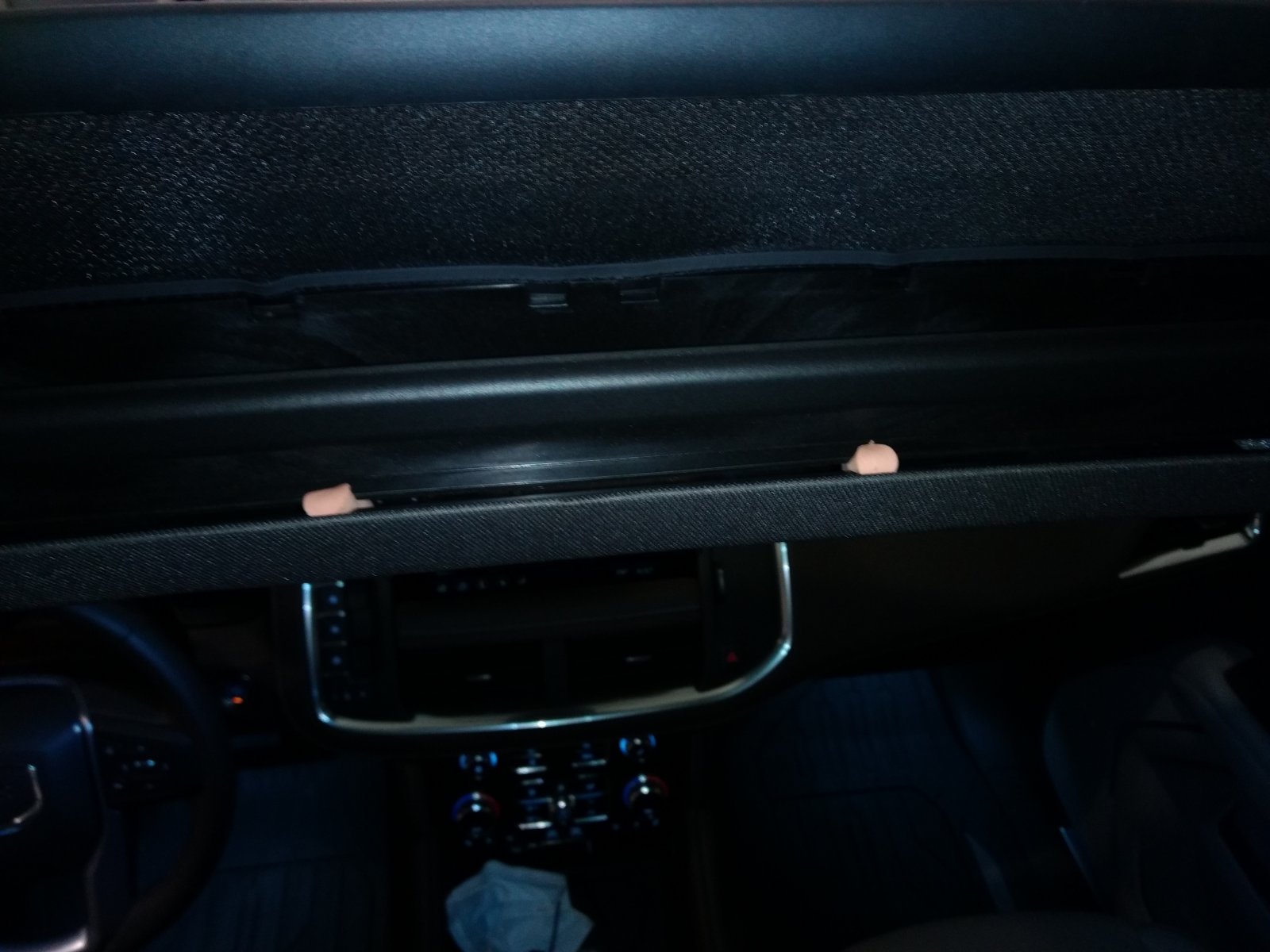

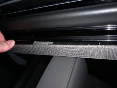

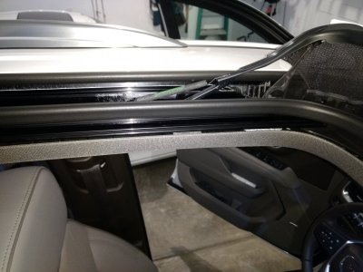

I shoved the foam right where those white plastic connectors are. You can pull down the headliner just enough to place the foam.
In the front I placed two earplugs in-between headliner. That area also makes similar noises.
IMG_20201012_175704812.jpg IMG_20201012_175710950.jpg IMG_20201012_175733642.jpg IMG_20201012_175721112.jpg

I pushed it right up against those white fasteners and made sure it wouldnt overhang the headliner. Made sure it was tight to limited any movement. I used a slim trim tool to work it in.
I no longer hear the creaks above driver's side and have yet to add it to the passenger side. Im sure it does it too (can reproduce with barely pushing on passenger side), but the distance from my head helps.
Are you going above the white clips or putting below the white clips?
I couldn't go above or below, because its connected to that aluminum frame and headliner bottom. I just shoved it right in next to it. The foam is essentially keeping pressure on the top and bottom(spreading apart), thus keeping it from moving and making. Hope that helps. I'm probably going to do the passenger side now, because I'm hearing more on that side now.
