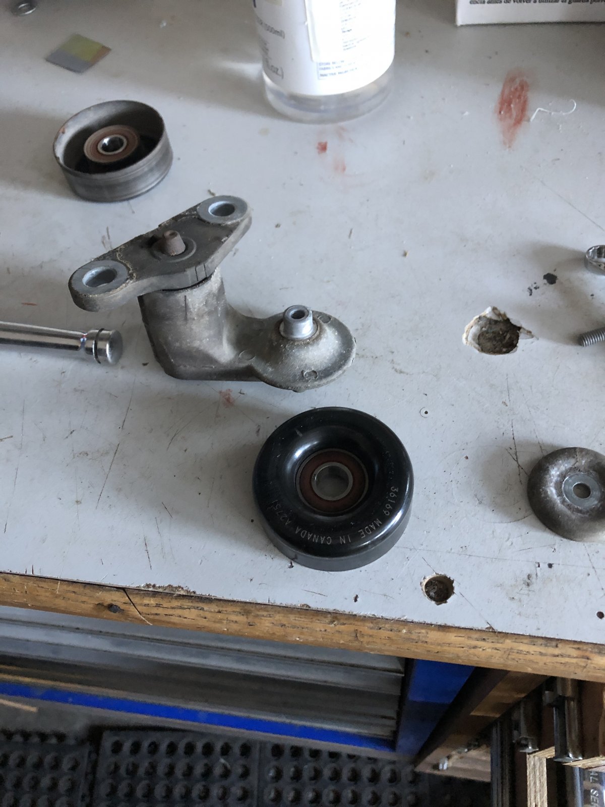

Just removed the a/c belt,had to pull it into garage for heat.Backed it out now letting it sit in the cold. 5f right now brrrr

Ok so started it again no noise. Yay.
Took it off gave it a spray and didn’t tighten the pulley bolt so much as it was pretty tight. Got it back on will see what happens.
