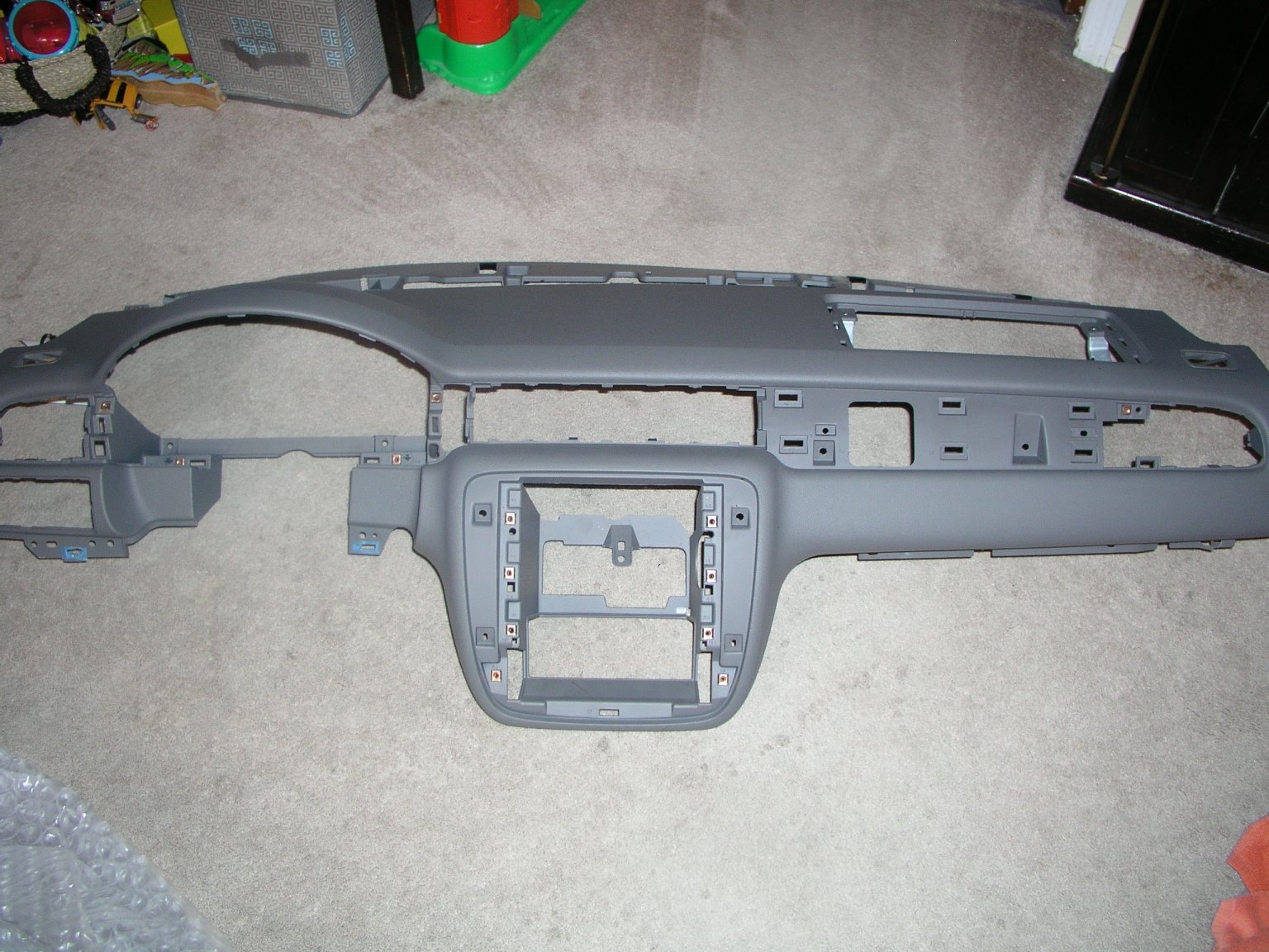

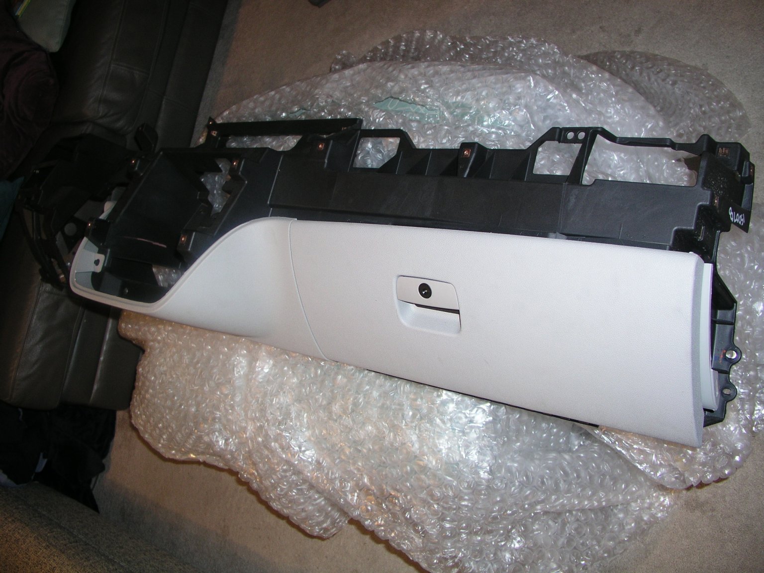

Finally had chance to take apart the new dash. Here it is before I took it apart. I will post the install may be sunday night.

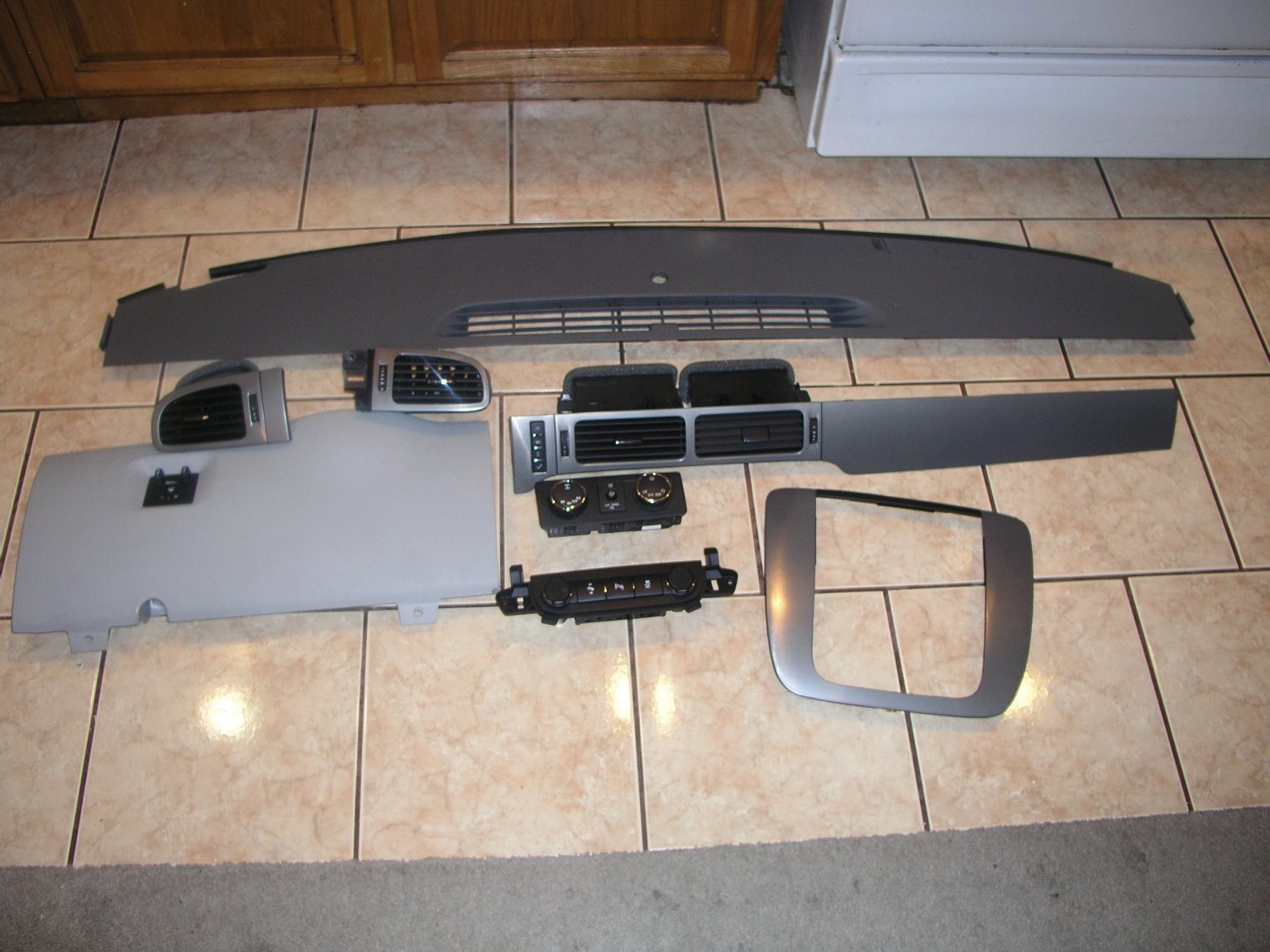

Here it is completely apart and the left over stuff I posted on eBay for sale.

So what part of your dash was broken? Yes, the entire front pieces have to come off to replace the top dash parts, but you show everything that had to be removed.

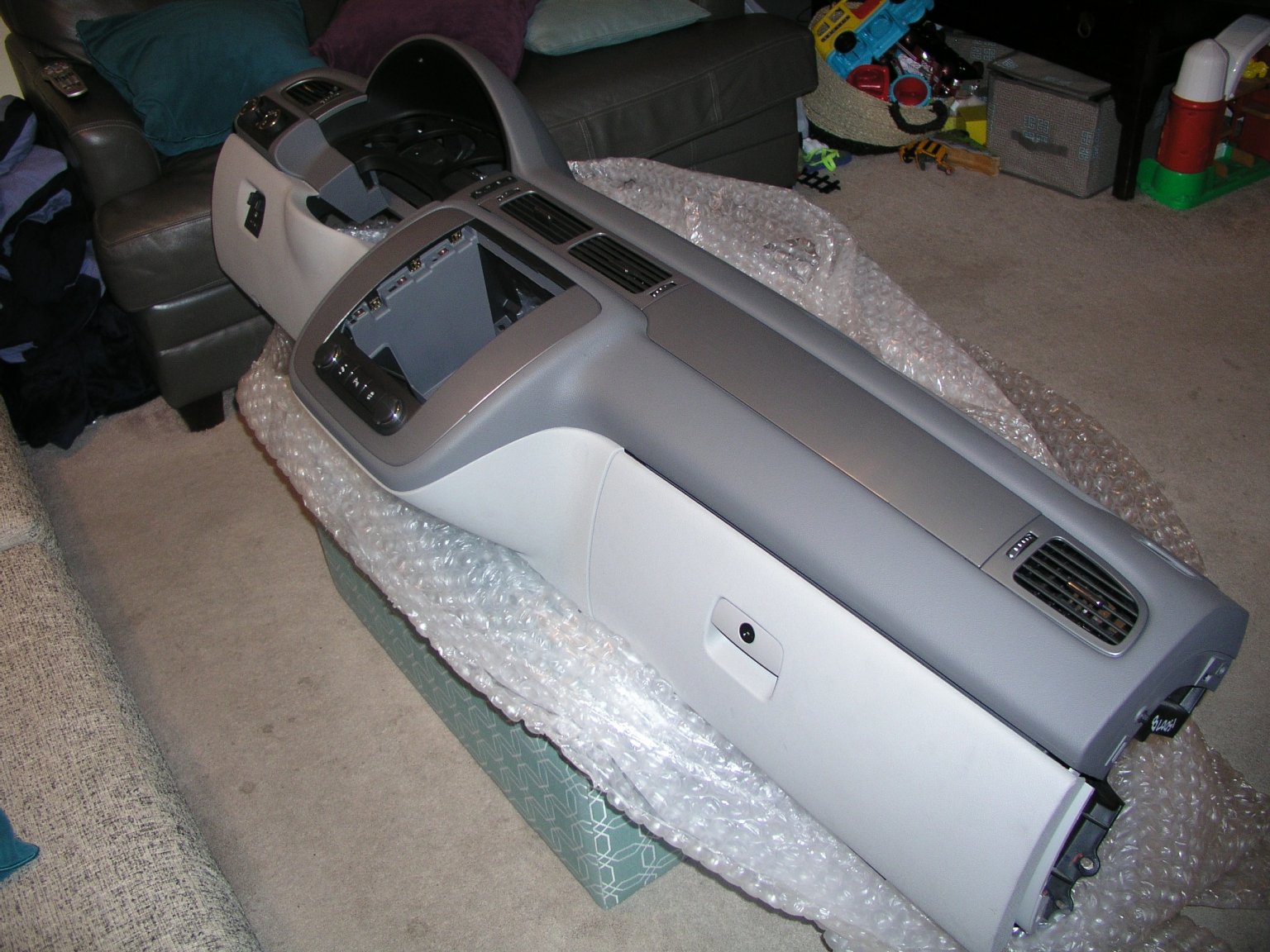

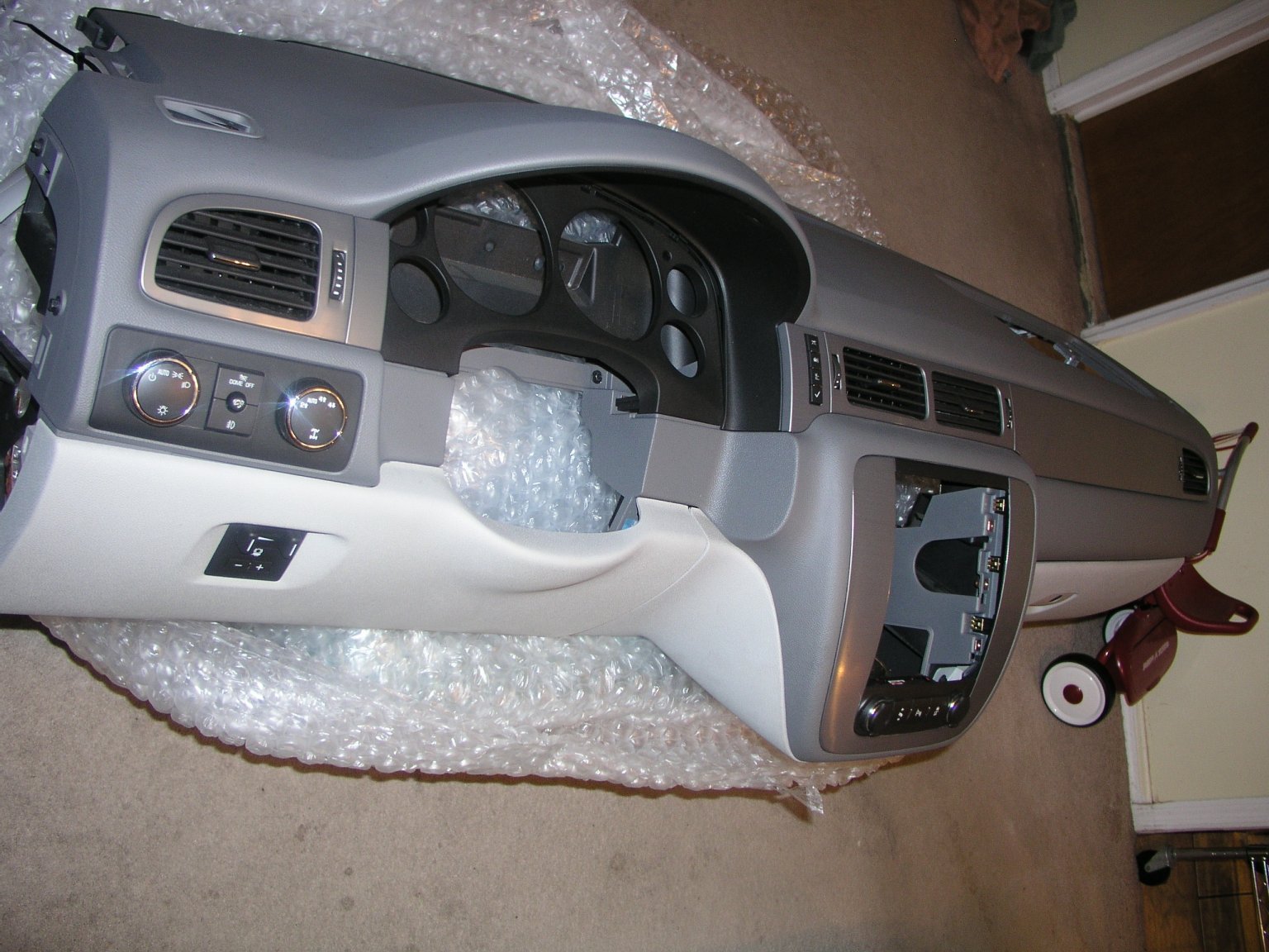

The part that was cracked was the part over the instrument cluster and airbag, due to the cracks i was getting a lot of rattling. The pics is of the new one that I will install this weekend if I decide not to wrap the dash in leather.
